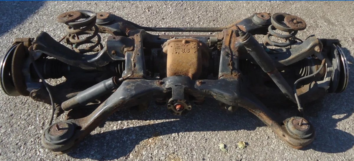

Found it!
This is the Thunderchicken rear end in question.

Found it!
The SC rear has bigger diameter axle shafts then any other MN12 chassis car and the biggest brakes.
The Mark VIII center section is aluminum... all others are cast iron.
