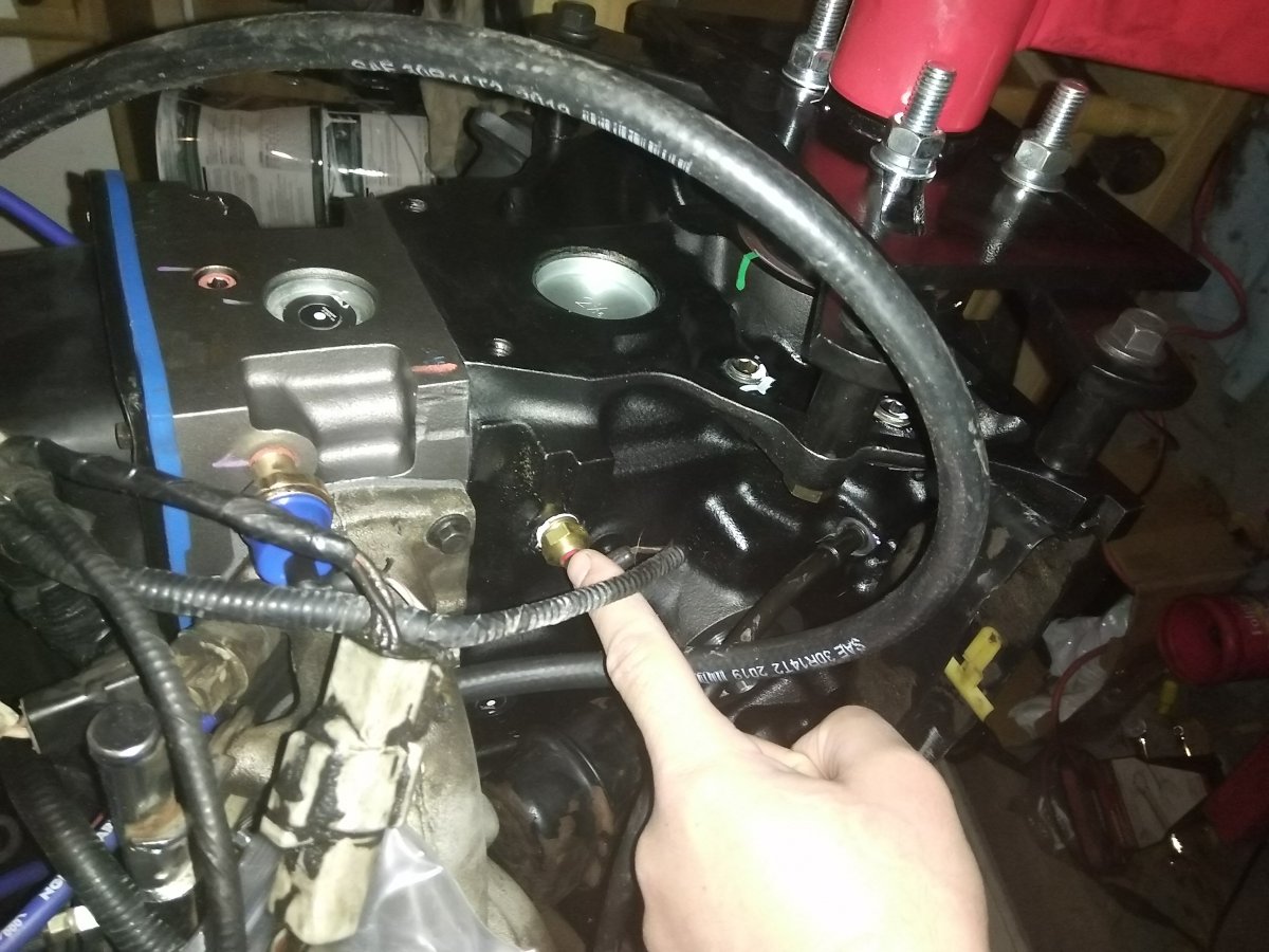

Can anyone tell me where the temp sensor that sends to the gauge is? I can’t find it to save my life
on my 88 with a 2.3 it’s on the intake manifold right between the second and third injector
What year? My 93 has the sensor right in the heater core line. But the sender to the gauge is directly below cylinder 4 on the driver side.
It's really hard to see when the engine is actually in the truck. Mine happens to be on a stand at the moment. The eye injury has set my schedule back a bit.
Coolant temp sensor
The picture came out sideways for some reason. The top of the photo is the back of the engine (towards the firewall)
