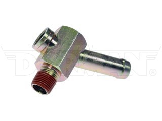

I have the same problem on my '96 4.0. It has been there for at least 16 years (I bought the truck 16 years ago). I replaced the rad, water pump, and thermostat (OEM part). It is a non-A/C truck with no heater control valve. (I added A/C but did not add the extra controls) .With the service part not available I've just been putting up with it and hoping it doesn't do any damage (397000Km now, and still thumping along ). Just found a reccomendation to add a 3/8" bypass at the heater core using 2X6 47147 Dorman "T"s. Ordered them tonight from Rock Auto and will install as soon as they get here and see if it works!!!
