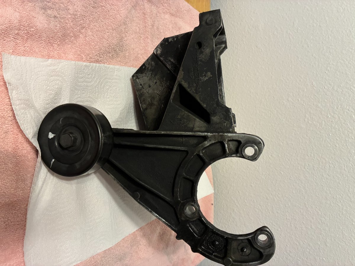

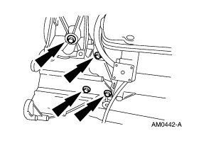

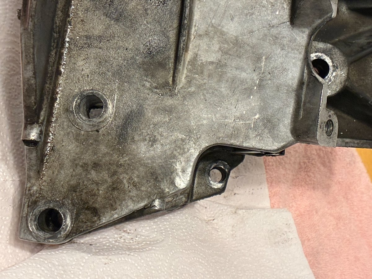

Hello, I am looking for bolts sizes for 1996 Ranger 2.3L AC/PS bracket. I have the part# for bracket F57E-19E708-AA and the bolt part #'s N606051-S309, N606572-S426 & N606068-S437. All bolts are discontinued, so the dealership was unable to give me bolt sizes. I did try junk yard, unable to find any bracket or screws. I need to replace, any help would be appreciated. thanks

They should all be 10mm threads if I remember right, the three long ones might be the same length that I'm not sure on the length, the short one is probably like 1.5" long or less so 30mm?
Thanks, from what I can gather. The two bolts at the bottom are…
10mm x 1.5 x 80mm
The one that goes underneath the compressor is about
10mm x 1.5 x 130mm
The one on the top right, I guess is about
8mm x 1.25 x 100mm
But not 100% sure on the length for the bolts on top. I have to prefer the bolts and then go from there.
