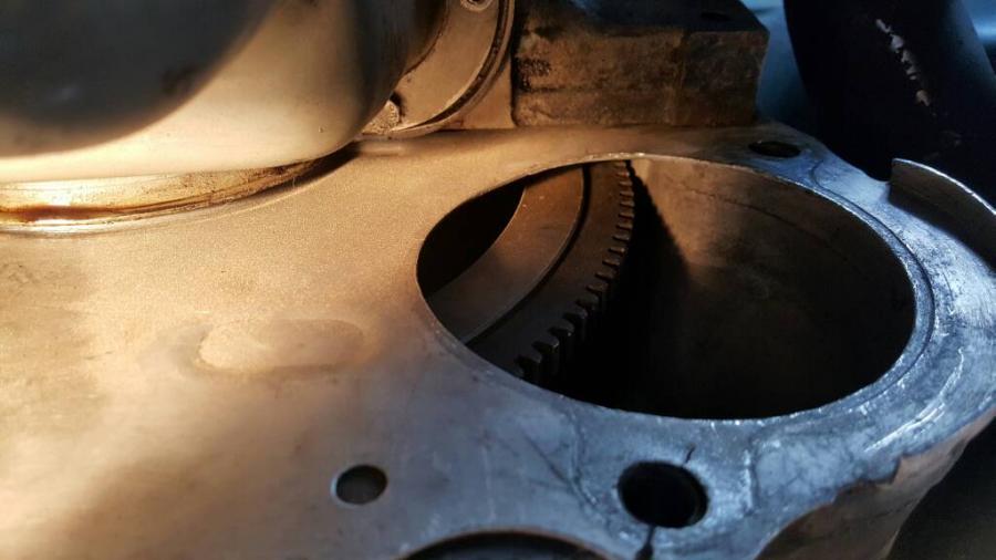

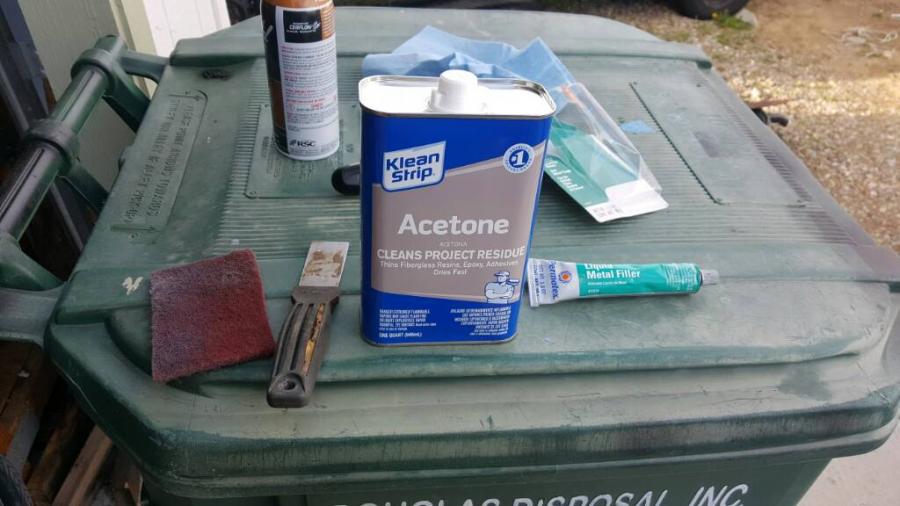

This is what the plate looks like. I cleaned it real good and applied my first coat of liquid metal. Looks like not only was it worn to where the old starter was but it also looks like it was not flat either. So far I have 20 dollars in the fix. I also miked the thickness .056 so I can find some stock at work in case I have to resort to plan b.

That plate looks great. My 2.9 plate has a few extra holes as well.
Well after three coats of liquid metal it came out flat. I bolted the starter in and cranked it over a bunch of times and no more issues. I did this fix for under twenty dollars including buying a rat tail file. A much cheaper fix than buying random expensive parts that don't fix the problem.
