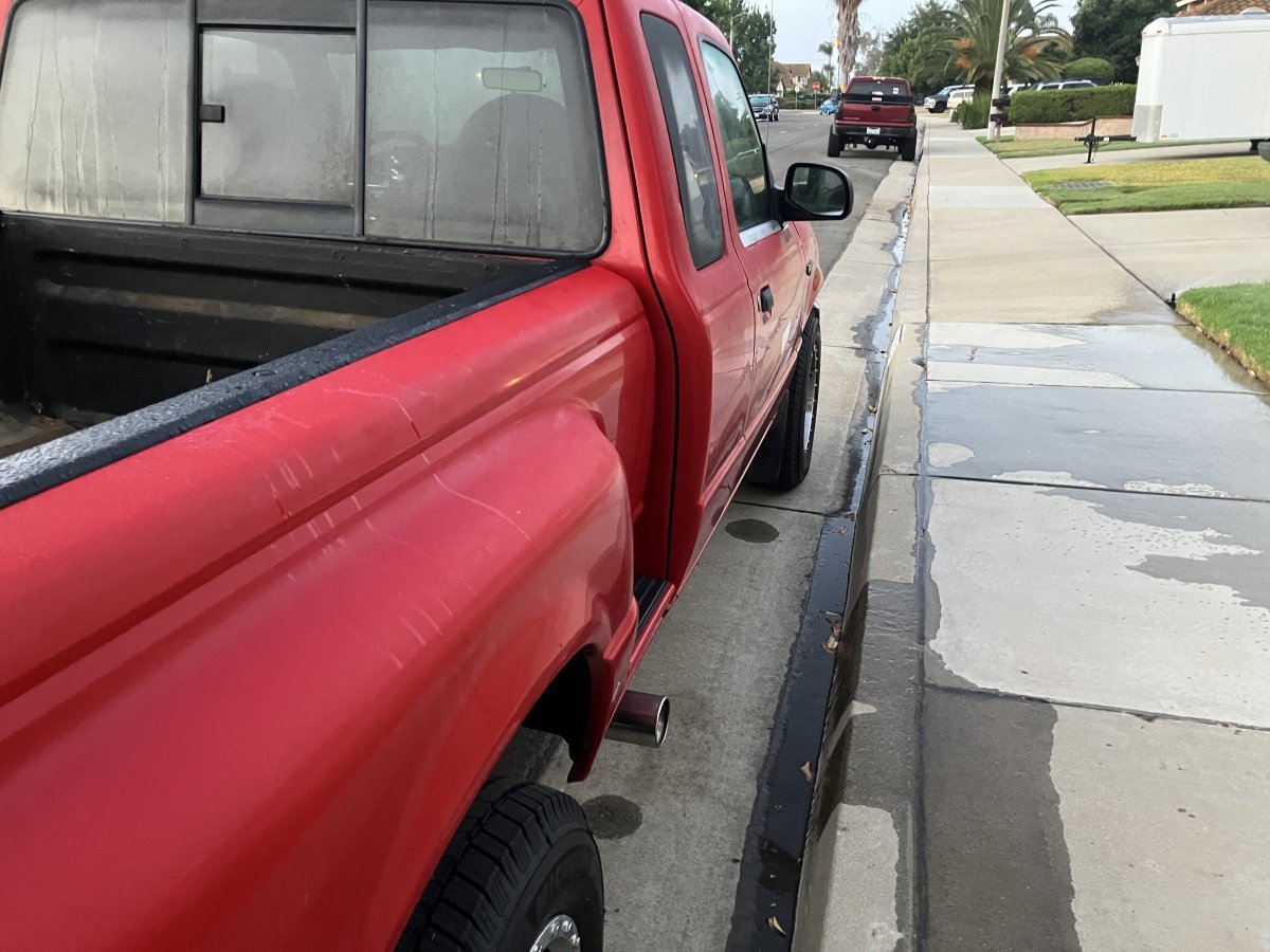

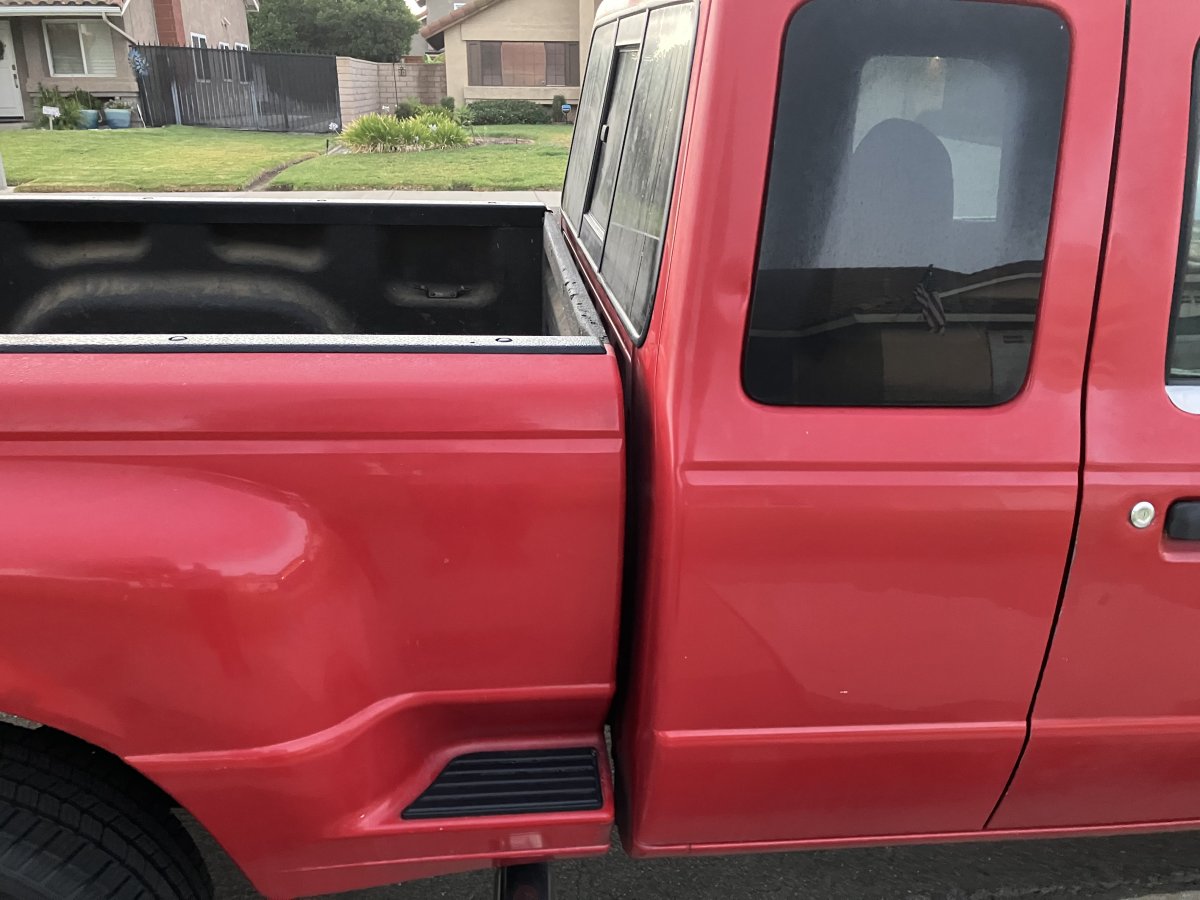

Here are some current photos of the bed and body line. I have not done anything to adjust the bed yet myself. I would need help to do that. You can see that it sticks up and is back a little to far so there is a gap.

If you saw this truck you would definitely suspect frame damage
I see it and suspect it has a body lift gone wrong. At least that's make first thought.
I say body lift... because the gap between the bed and bumper tells so.
Got pictures of the cab mounts?
Also pictures of the bed mounts...
