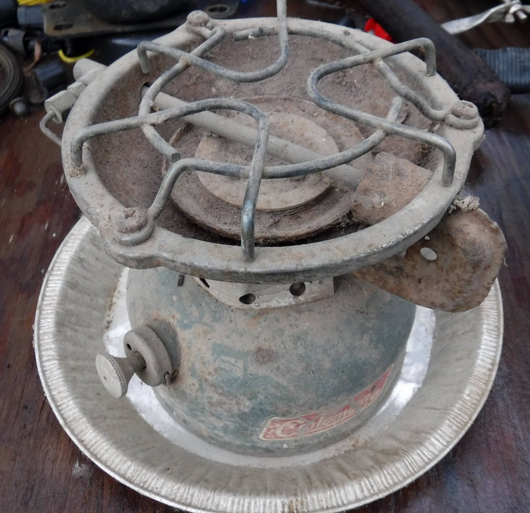

I was looking through some old boxes of my father's in the back the other day and ran across this little coffee maker I guess. I remember he also had some of the round heaters
32717
I was looking through some old boxes of my father's in the back the other day and ran across this little coffee maker I guess. I remember he also had some of the round heatersView attachment 32717
Looks like a 502 backpacking stove? Ancestor to the black one I picked up a couple weeks ago.
It should have the model and month/year of production stamped on it somewhere.
Mine had it on a part below the burner, with the older style fount it might be on the bottom of that (mine is kinda domed and has feet so it isn't a "normal" fount)
It has a 502 on it, but I couldn't find any other numbers stamped there. I need to clean it up, along with an old Dietz N0.2 hurricane kerosene lantern I recently purchased, which is even dirtier than this, but it isn't beat up, just years of sitting in the barn I guess. I'm fairly certain there's an old Coleman lantern back there somewhere too, need to go back and review this whole thread again.
Will diesel and a paint brush do ok to clean them up?
The founts are just painted, the decal may not like it.
Vents on lanterns are ceramic coated to take the heat, some chemicals (like vinegar) can react with them.

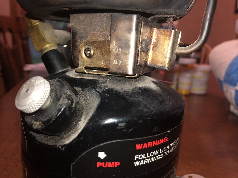

Mine is like 30 years newer but here is where they put the date on it:
