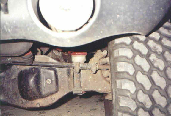

I had a set like these on mine for maybe 5 years without any issues.
I cannot disagree about the washers though... Cheap, simple, effective.
