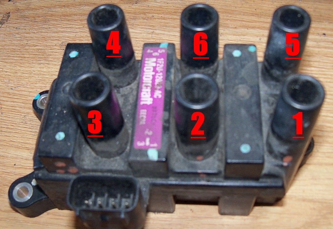

Our coil packs are waste spark, so there are 3 coils in the coilpack and each one controls the spark for 2 cylinders. It fires the spark for both cylinders at the same time even though only one cylinder will use it (wasting the spark on one cylinder). The coils and numbering vary a little by year, but this is the basic idea:
Image result for ford 3.0 vulcan firing order
What that means for you, is that if a coil has gone bad, you'd probably have misfire codes for both cylinders that the specific coil fires instead of just cylinder 2. For the pic above, you'd have misfire faults for cylinders 2 & 6 because that coil controls spark to both of those cylinders.
