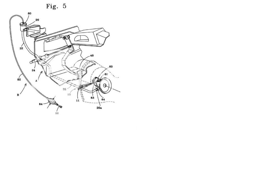

I also beating my head against the wall over this hydraulic system at the moment. I have been trying for days to get it bled. Being an engineer, i had the bright idea on the way home to design a tool, patent it, and get filthy rich. Unfortunately when i got home i found someone already had that idea. Check out this page.
http://www.patentstorm.us/patents/7013642/description.html
In particular, if your not much of a reader, check out this diagram.

Since I am mostly solo on this project, i think i am going to create this baby and give her a shot. I think if you disconnect the master from the fire wall, use a block of wood to hold it horizontalish, and pump away this might work....who knows?
might work.
