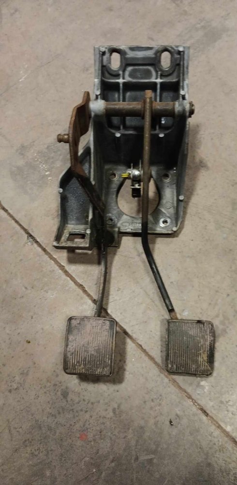

It appears that I have found what I need to complete my swap from an automatic to a T5 - first photo is my set of automatic brake pedal that I removed from the truck today and the other 2 photos is of the standard transmission parts that I need 20240708_164526.jpg448916819_1585642408667199_4175139914194463456_n.jpg449070547_406392899097156_3425288776203652961_n.jpg
