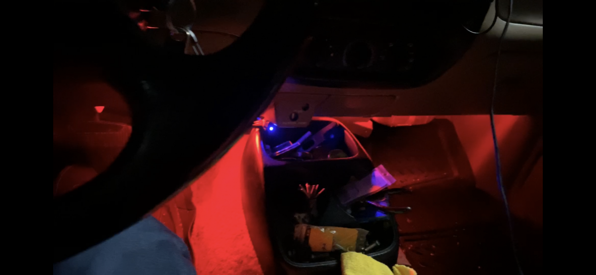

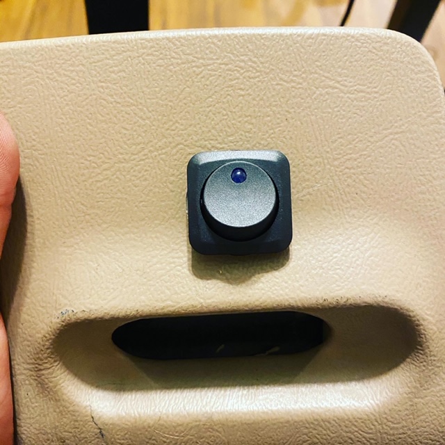

The finished result, the switch works now , and im going to run it up into the hole on the dash where the cigarette lighter is (what a useless tool)
36109

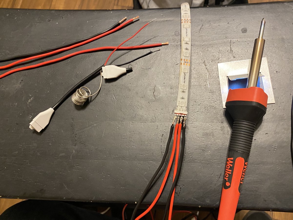

Glad you got it figured out... who knows why it was popping the fuse. But if it was a cheap switch and you soldered the wires to it... the heat could have damaged the internals or maybe some solder leached into the switch enough to short out.
Not sure why you just didn't use the connector/pigtail in your picture for the LED strip. Then make the wiring connections on the pigtail wires. Soldering those heavy gauge wires (at least twice the size needed) directly to the LED strip without a doubt degraded the integrity of the strip. Did you use heat shrink or something to keep those wires isolated from each other? That four wire soldered connection at the LED strip just looks sketchy to me. If you have trouble in the future with that system... those connections would be the first place I would look.
Good luck going forward...
Ummm yea, those solder joints at the light connection are gonna burn your truck to the ground one day. If that wasn't the issue, it will be.
the instructions said to solder them . They are isolated and that isnt possible ... I have an inline fuse right at the circuit
.0072" isnt exactly "isolated".
When I said isolated... I meant like... did you slip a piece of heat shrink over the solder joints individually?
I still would have suggested using the pigtail and soldering your wires there...
There were no pigtails on the led lights...they have prongs only. The hardwire instructions said to solder the prongs. I did wrap the solder joints individually and isolated them from eachother
I was just looking at your picture and it sure looked like a couple of connectors... one with a pigtail. That's why I mentioned it.
that is an extension plug
So... if you plugged it on... power and ground on the pigtail wires... The LEDs wouldn't illuminate? My guess would be they would... but not positive.
I don't understand why you keep saying pigtails, the leds dont have pig tails. they have prongs.

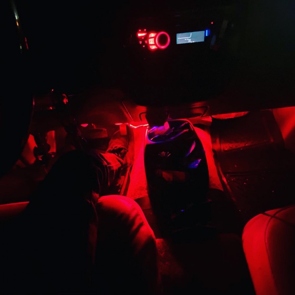

I still have a few perfectionist stuff to clean up on the light installation, but for the most part everything is buttoned up nicely now, circuits all secury with zipties and corregated tubing, I isolated the inside dash lights from the outside wheel well lights ran them on 20 and 25 amp circuits with inline fuses at the start of the circuit.
I don't know why I do either... except that you seem to have made one out of your "extension plug". Clearly you have it all figured out... good luck.
