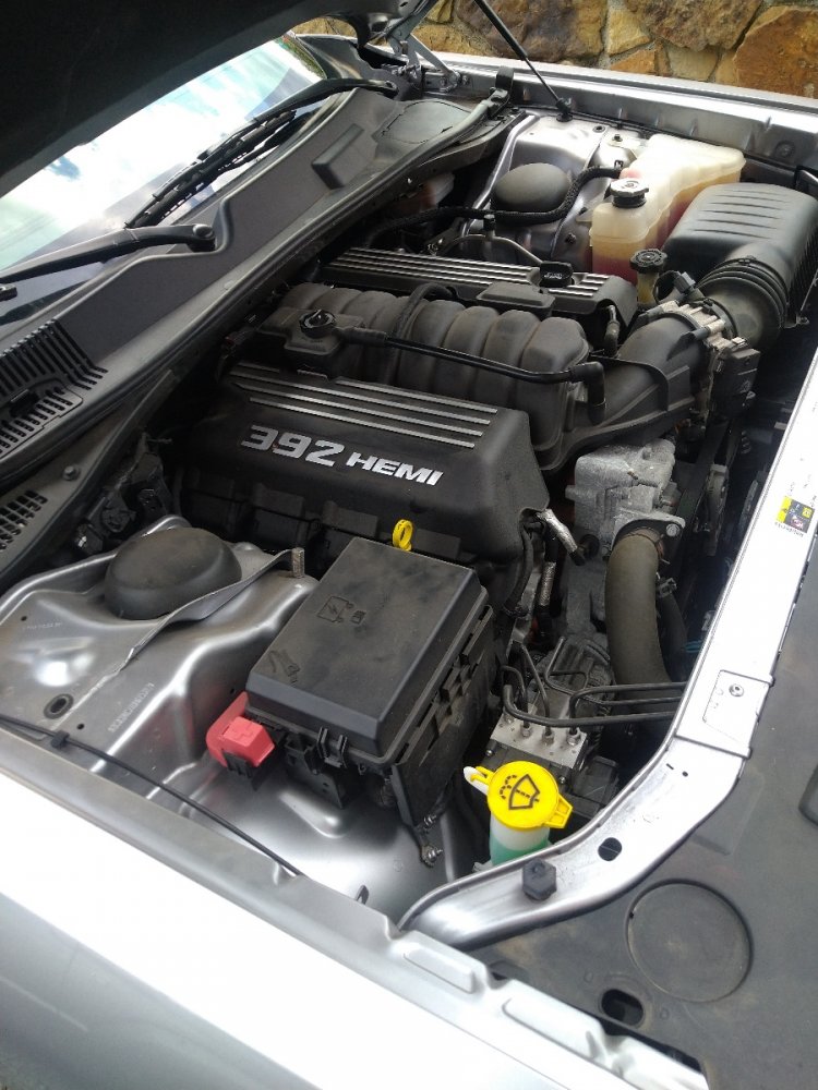

Threw a good charged battery on it and replaced the alternator. Voltage still wont come down below 14.5 no matter how long it runs. I can bypass the PCM control to the ASD relay by grounding it with a jumper wire and the rough running issue stops. Remove the jumper and the relay goes back to flicking on and off and engine runs like crap. So the issue is from the PCM control to the ground side of the relay. Still cant figure out why the voltage won't drop down to 13.5 like it should and if the voltage issue is causing the erratic operation of the PCM control of the ASD relay...
