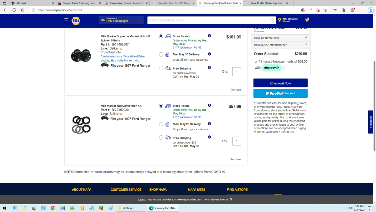

NAPA says they're right for me and just checking here. I think there's only one kind of MM hub that fits. I could save maybe 25+ elsewhere but some would go to shipping plus nice to get local if it's relatively competitive. Usually NAPA is way high but not so much here.

Ok, well, I ordered the MM's and nut conversion kit per your good suggestion, $200 with tax. Not horrible.
428 hubs and 95-27997 conversion kit. Should be correct.
