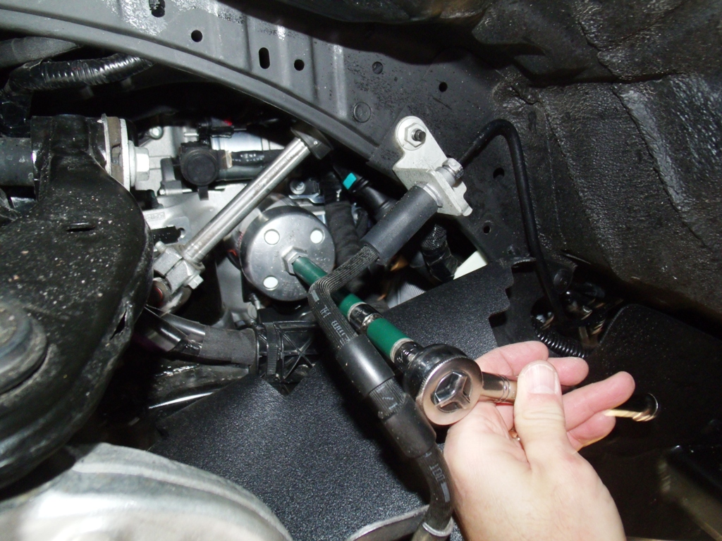

Ok I done my second oil change today. Did first around 1500 just to break in I guess. My own comfort zone. To change the filter you have to remove this rubber flapper thingy in the driver wheel well. The first time the I couldn't get 1 of the little plastic things to screw out. Well fine to took the others out and swung it out of the way. Well today 2 more wouldn't come out. Am I the only 1 this is happening to? Just a question. i ordered some more off Amazon for about 5 dollars but who ever came up with those little things should be taken out to the barn and get their ass whooped haha.

Yeah, those fasteners are a pain. Often the force you need to keep the screwdriver in the head is more than the threads will take as they try to back out. I usually end up putting a tiny screwdriver under the head of the center part while I use the screwdriver to unscrew it and that mostly will work. Unless its in a spot where you cannot get both hands in there at the same time... If I have to replace them I use christmas tree fasteners.
It’s easier if you pull the tire but not necessary. I try to remember to do it when I swap tires just because I’m pulling the wheel anyway for that and to inspect the brakes.
Pretty much any vehicle I’ve had with those fasteners have had an issue.
I've done 4 oil changes on our 2019. For those pesky little black fasteners, if you take a flat blade screw driver and slide it under the outer ring and rotate the screwdriver slightly to apply a little outward pressure, and then use a phillips screwdriver in the center screw, the screw will come out every time... well it's worked for me every time anyway.
