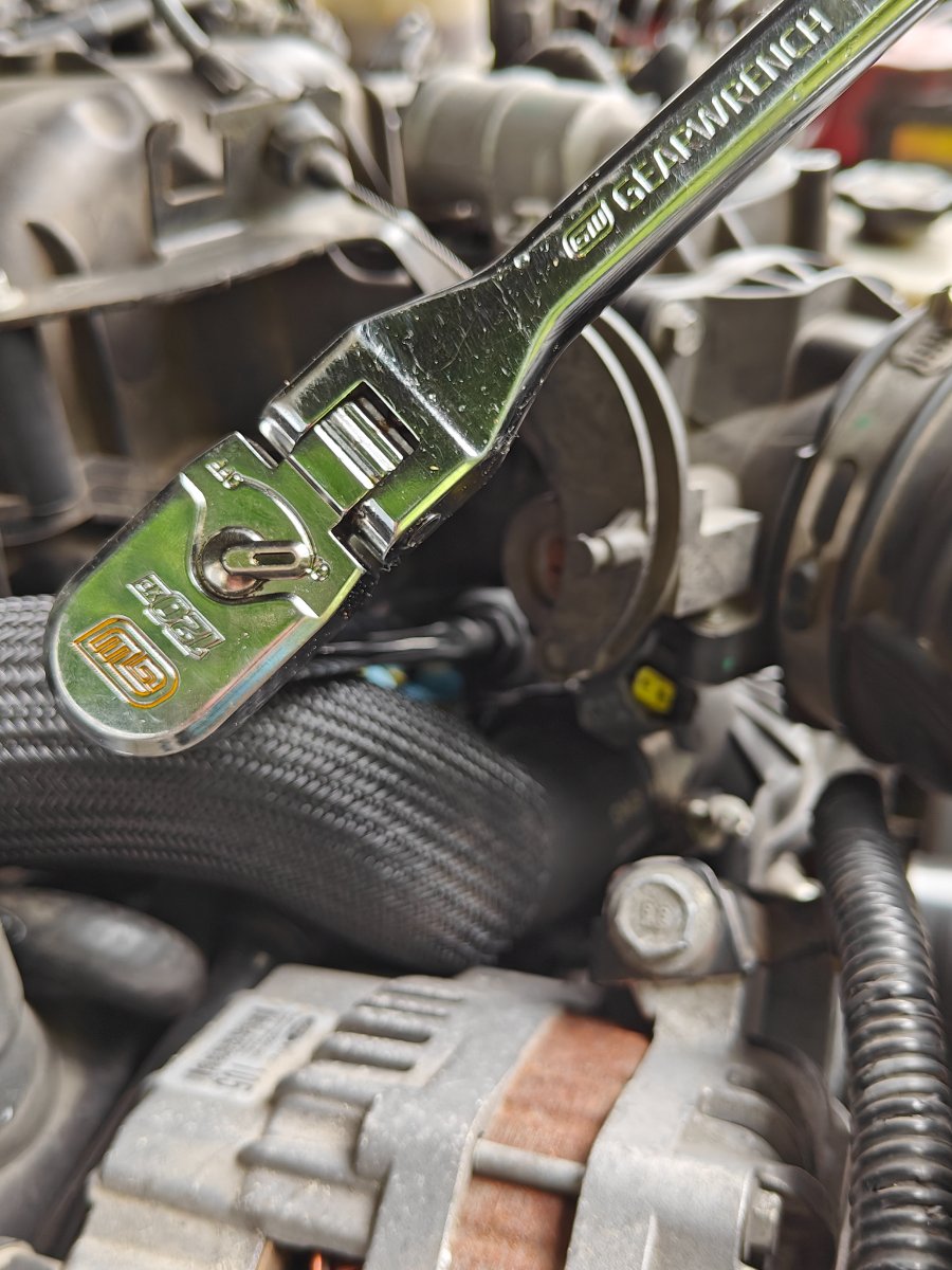

I'm wondering though for those that have changed the front tensioner. What's stopping me from loosing it with a 27mm wrench and finagling it out by hand? I've read a lot of posts where people say to remove the throttle body, t star housing etc. but to me it looks like I might have to remove my one coolant temp sensor but from the it's home free? I'm not pre priming them so going back in should be easy enough with some doing? I can reach my hand in under the EGR and turn the tensioner no? Just trying to prepare myself and gather as much info as possible before doing it outside in freezing temps lol.

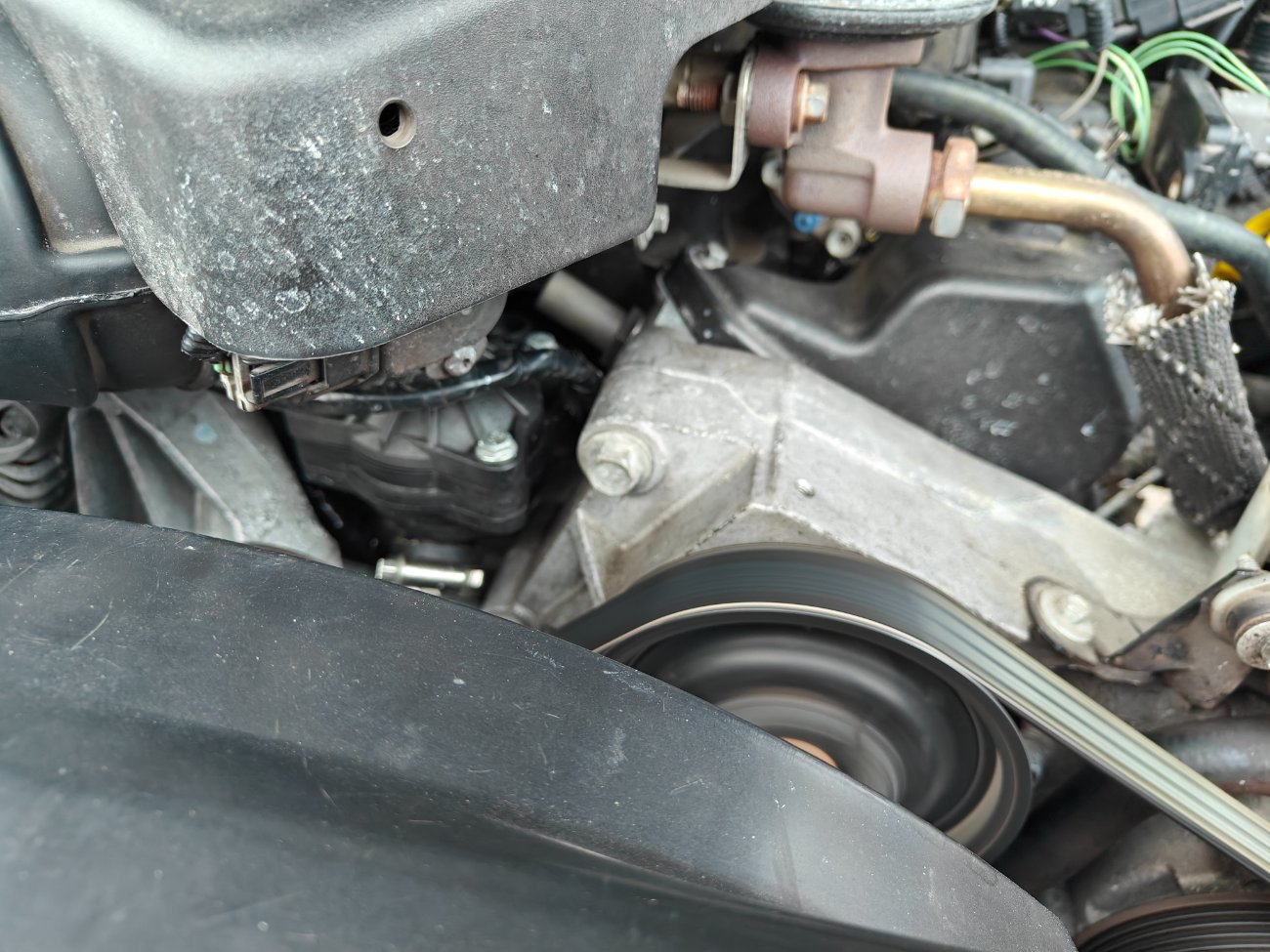

From what I've read and been told, I can take the passenger fender liner out and that tensioner will be staring me right in the face so it should be an issue. I have a 30°/60° angle open end 27mm wrench to use if I have to.

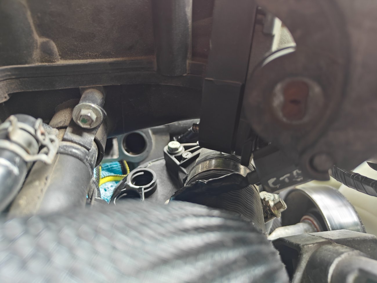

Also, if your Ranger is like mine with only one coolant temp sensor, you can easily get to the top tensioner by just removing the sensor and using a socket w/ 10" extension FYI
I did exactly that last time I changed mine. My intake has to come off this round for injectors anyway, so doing a bunch of other crap while I'm in there. Laying all the groundwork to finally put this stupid moddbox kit on.
