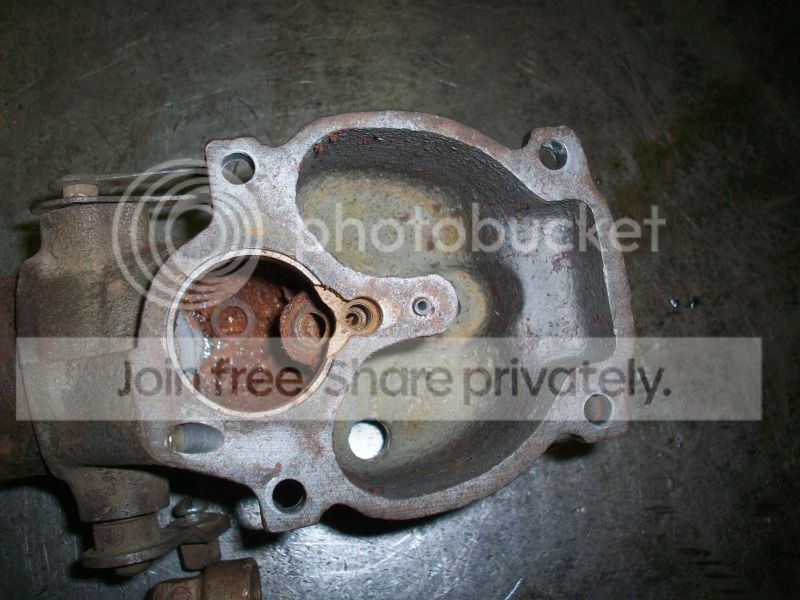

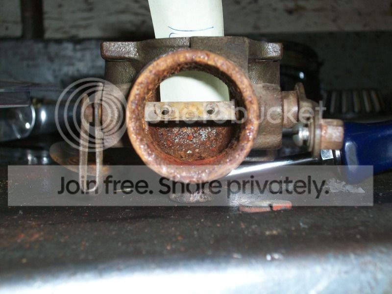

I have been busy and since it is kind of an odd sized tractor that hasn't been falling into any jobs my ol' C has been sitting for a couple years. I am moving to a place I can keep it inside (and with a belly mower mow my yard) so dad said to get it out of its shed so he can get his baler in for the winter or he will drag it out. I dump gas in it, let it run out the bowl drain to hopefully flush out any trash. Of course when I close the drain it runs out the air cleaner... tapping with a screwdriver handle wouldn't stop it so I rip the air cleaner and carb off and tear into the carb. The needle had rust bits in and the top housing and the intake tract of the carb look pretty tough as well. No trash in the sediment bowl and there is an inline filter as well. Kinda glad the needle didn't seat so I didn't suck all that flakey rust through the engine...
I am on a timeline so I went ahead and cleaned up and put a kit in it but it would be nice to know of anything if I run into it again.

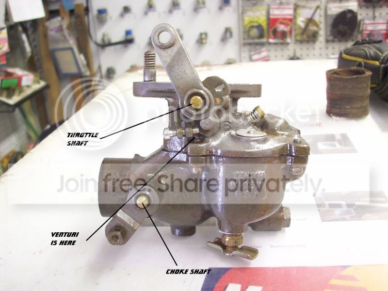

The choke butterfly shaft is in the bottom pic, it actually took a litle doing to close because it was stuck open.

That flaky crap in the choke was barely stuck to the housing. If the needle hadn't messed up I would have been running that through my engine, wonder what the valves would think of that...

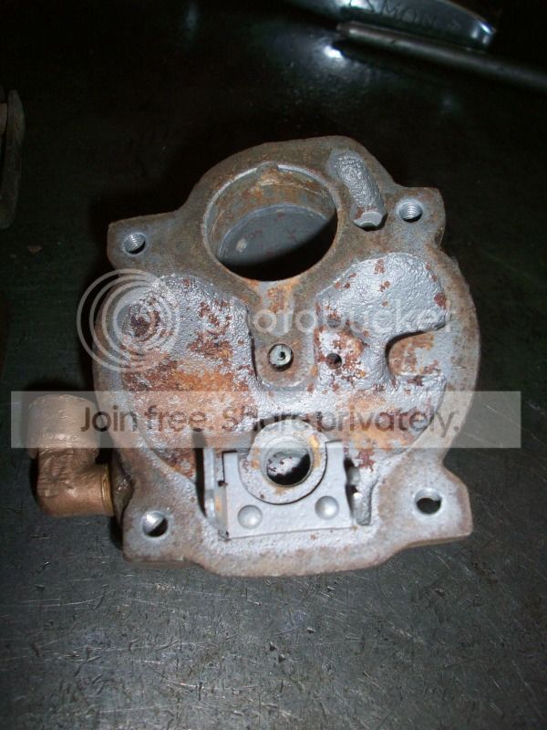

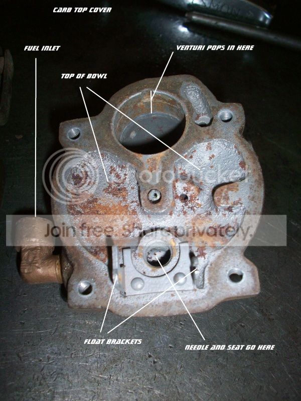

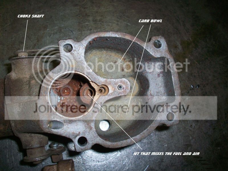

There is only gas in the bowl, the crusty part near the choke only has air in it, the venturi is in the upper part and only has the throttle plate above it before it goes into the intake manifold.

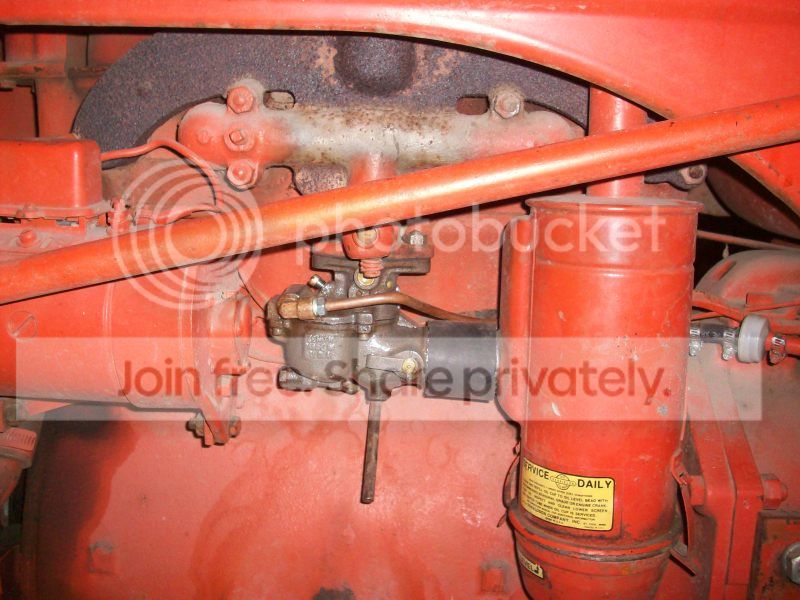

This is an updraft carb, you guys may not that familar with how they work. I mainly want to coat the bowl and the carb intake tract up to the venturi in the bottom part of the carburator. I wish I would have taken pics before I put it back together... these are with most of the parts removed.

Assembled:
Carb Coating
Mounted on the tractor and waiting for me to get new hose clamps. Runs great BTW :icon_thumby: No matter how you turn the wheels the steering shaft (it is a push/pull setup, it doesn't turn) it is always in the way. You can see the silver throttle lever peeking out on the backside of the intake.
