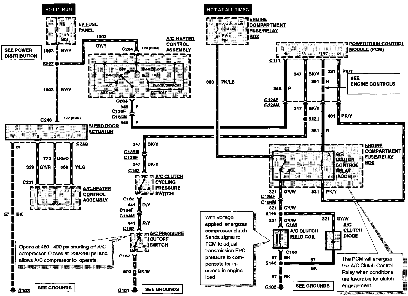

I was hoping to get some insight on my 98 4.0 ranger's AC.
I just recently bought the truck two weeks ago and I have been trying to work on the AC. I've checked the fuses and relay. I've tried to jump the low-pressure switch and have replaced the compressor clutch switch connector but still can't get voltage on the clutch connector.
Never done any AC work so this is all very new to me. Any advice is appreciated
