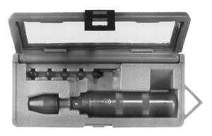

If the head of the bolt is severely mangled try going down one size socket and hammering that on. Worked for me several times. Might also try a hand impact driver. Pretty awesome little tool. They're the only way to take a motorcycle engine apart.
Edit: Just in case somebody doesn't realize what I'm talking about: Hand Impact Driver
i was wanting to pull them together as one at first. but then realized the front clip is welded on and not bolted. also its not one of the top bolts if your looking at the tranny from the back its on the right side. i beleive its the lowest one. and i dont see how a hand impact would work. doesnt look like theres any leverage
