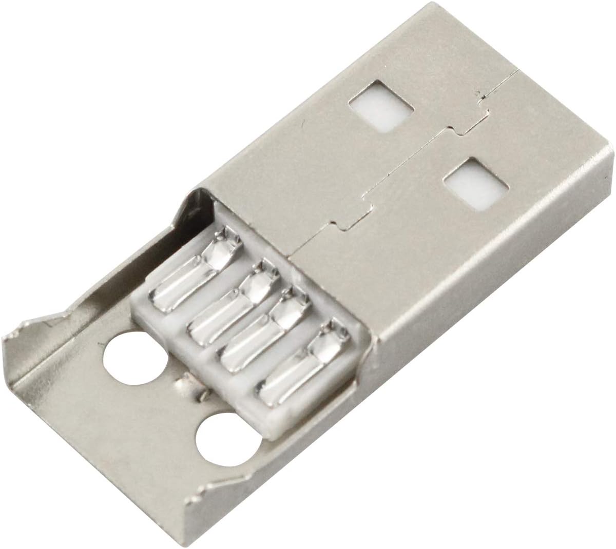

Anyway, I went with @kunar idea, bought these.
We will see how well I do. I actually kinda suck at soldering small stuff like this but they come in a 10 pack so I have more than one chance to get it right.
Try a hot air rework station some time if you get the chance. Just apply the solder paste in the general area it needs to go, point the hot air at it, and it wicks onto the solder pads like magic.
I'll have to google this. I've used cold solder alot over the years. Just conductive epoxy basically, it ain't great but it works. I think honestly I just need a good solder station. My small solder tool is butane so very limited heat control. When I do automotive size wires I just take the tip off and use the open flame. I'm impatient so like just hitting it with fire for a second and solder sucks right in. Don't work on tiny stuff like this though.
