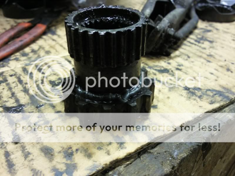

next thing is im gonna weld up my auto 4x4 hubs like i did with my old ranger for this winter :))
liek this hehe
