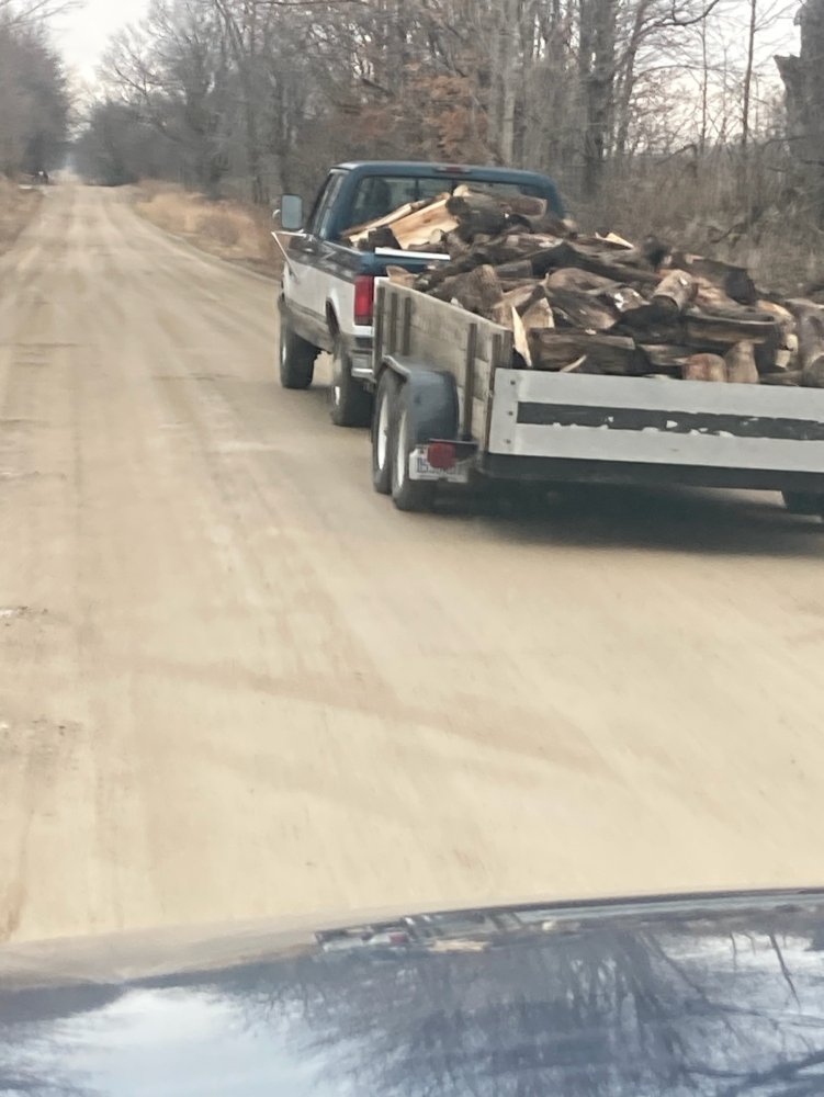

That's pretty much how I do it too. It's worked well for hauling everything from ATVs to loads of furniture to a cord of firewood.

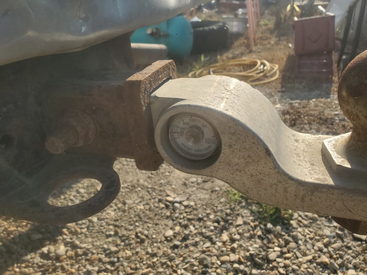

Pic of my reciever with integrated scale;
I had considered one of those but they don't make one light enough scale for it to be useful to me.

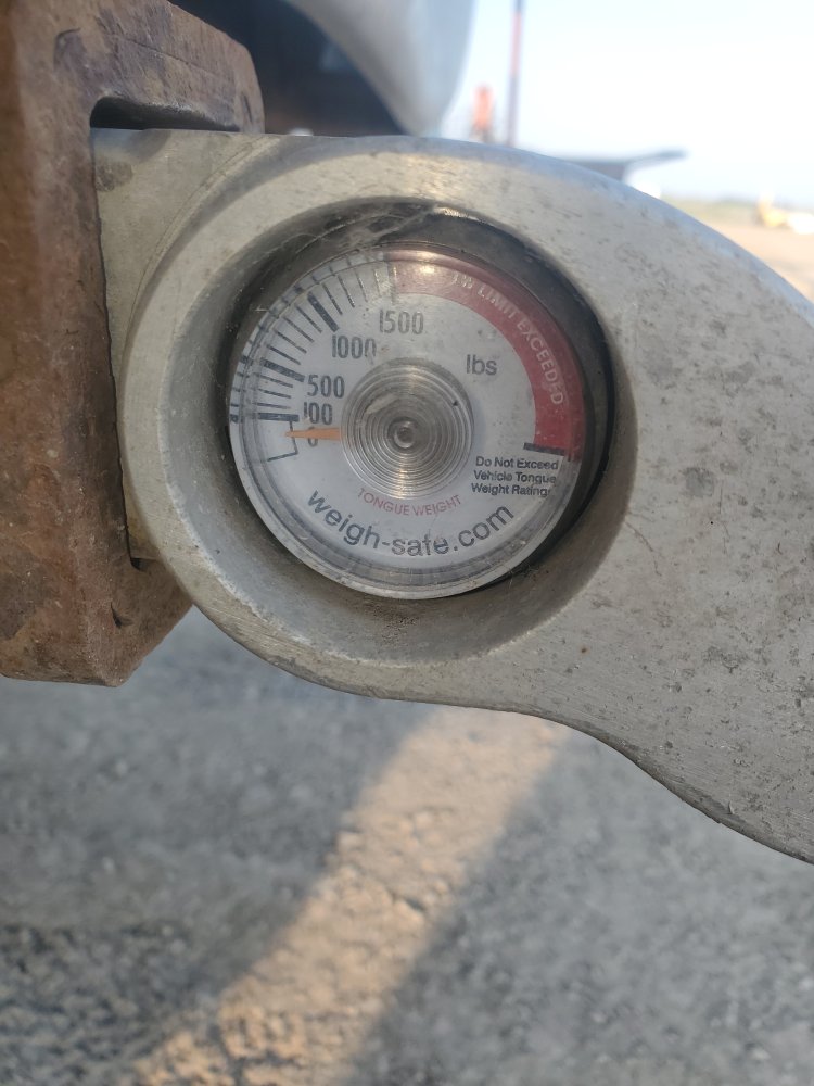

Hmm, I think mine goes from 100 to 1500 lbs. I'll check in a bit.
I need something with a channel since I don’t have a regular ball draw bar. I have a Lock N Roll hitch system since my trailer goes off road. It’s too easy for a ball and hitch system to either pop off the ball or damage the ball or coupler since they don’t have enough rotation.
I thought about buying one of those kind of hitches....but i know how i am id try to see if i could break my truck or the scale first.
I bought a receiver with an integrated weigh scale. It works good. I found it on clearance sale at Princess Auto. I don't "need" it but the price was too good to pass up.
