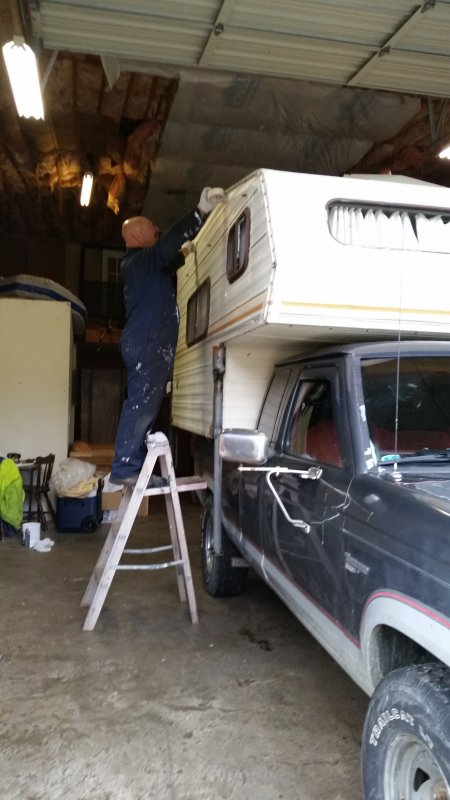

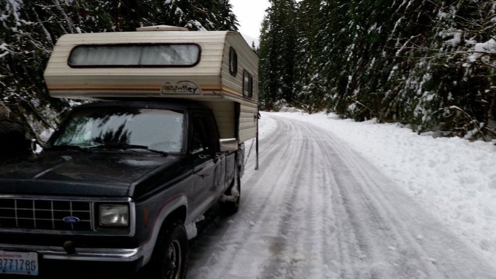

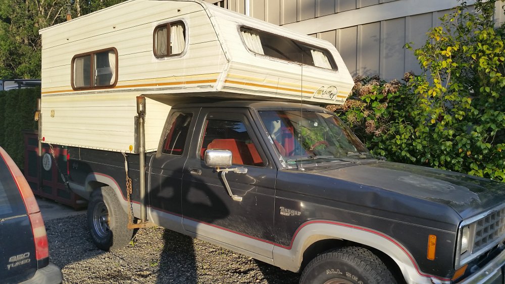

anyone that says it can't be done is wrong, the truck, camper, and boat has been in my family for 26 years. The truck is a 2.3 l V6 and holds my cab over camper and has done trips of 400 or more miles each year up and over passes, to the mountains, to The Gorge for concerts, and its never giving me a problem besides changing the brakes and oil and a bit upgrading to the suspension which required another leaf spring. Back in the day even carried along the boat (18 ft aluminum Smoker Craft) with the camper. I feel like I should be taking it easier on it now though and keep it to just a camper with the 300k miles ive done.. as long as if you check everything twice and do proper maintenance you should be fine oh, and turn some heads while you're at it when they see this. You might be going in the slow lane up steep hills and high elevation LOL
