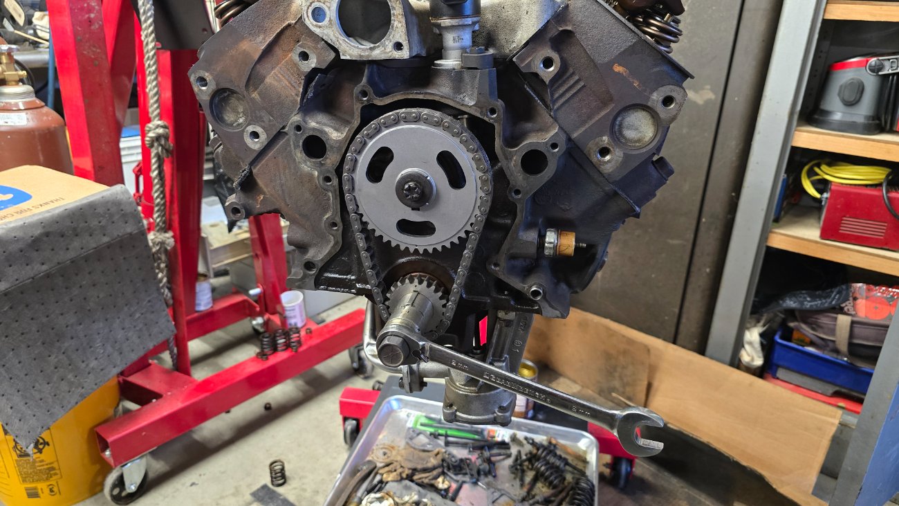

Hey C-hound. There's your missing spring on the floor.
That's one of the old springs. I accidentally kicked it off the base of the engine hoist and didn't pick it up right away. Tomorrow, I plan on moving the motorcycle out so I have room to clean up and work there. I have one new spring retainer to replace (the kit contained the wrong # of exhaust retainers). Then, I'll put the timing cover on, followed by the water pump. After that, the freshly painted valve covers and oil pan. That should finish the engine shop work. Rebuilding the 4r70w is next before shutting down the Ranger and removing the 3.0l/M5OD/1354e combo.

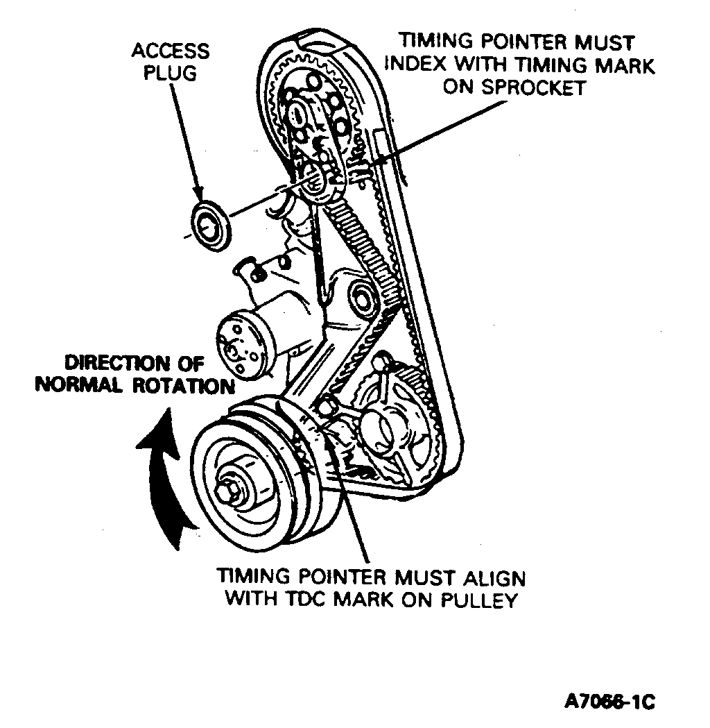

EDIT: remembered it wrong. Service manual screenshot below:
