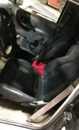

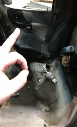

So how much modificat did the miata seats need to fit?
Well I got the miata seats for $75, no tears or anything. We separated the "track" part of the seat tracks bolted those two frame pieces to the floor and tack welded a beam across either one to keep the shape when we unbolt it. We took the miata seats which had the tracks still on the seats, cut the pegs where the mounting holes were and welded them straight on the ranger seat track/frame
