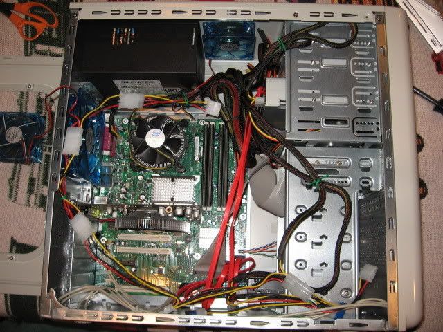

It took some doing, but I have most all of my wires either routed around the edges of the case, or tucked behind the motherboard panel. Zip ties help out a lot too.

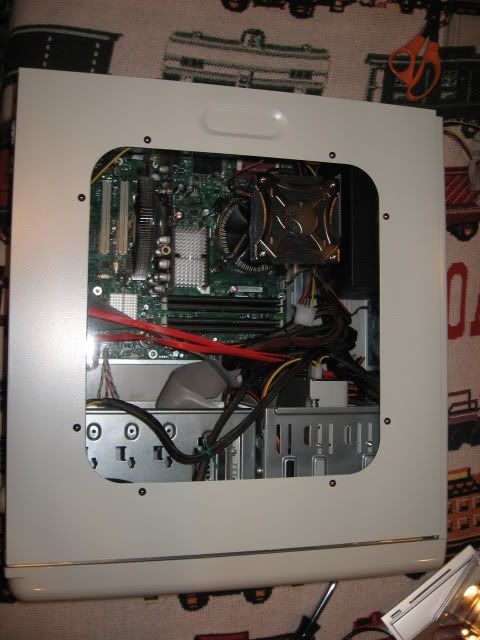

Nice. That sure is a purty PSU.
The motherboard temp dropping really isn't a bad trade-off, and I forgot you'd said it was quite dusty there.
I think what's happening is the back exhaust fan is pulling away a bit of the cool air the side fan is bringing in to the CPU, but you've still got good temps, I'd leave it the way it is.
Not to bad Looking there. he heat rise is due t the filters you put on slowing the air flow, but the temps are still very good.
If you zip tie your cables to gather the temps may drop a little due to better air flow from not hitting the cables and slowing.
I like the case for the fans that is why I told you to get it and the price is not bad.
Looks like you have a nice system over all that should last you awhle.
Need to get a pic of it all lit up glowing Blue in the dark Now :)

I may still try to re-arrange the wires some, but I was having a bit of trouble trying to get all of the wires from that larger PSU routed out of the way.
I'm going to get another couple shots of it after I clean up my mess around here some again (haven't really had much time) and I need to sit down an figure out how to shut off the flash on my digital camera to get a pic of it all lighted up. Not that I really care about the lights (I would have been happy without them), but... they're there so I saw no reason not to light 'em up.

I wound up taking my whole setup apart after I built it to reroute the cables because of the way the PSU, Mobo and CPU heatsink sit so tightly together... plus it gave me the opportunity to cut a hole in the front for a 120mm fan and completely cut the fan holes out in the back for better airflow.
