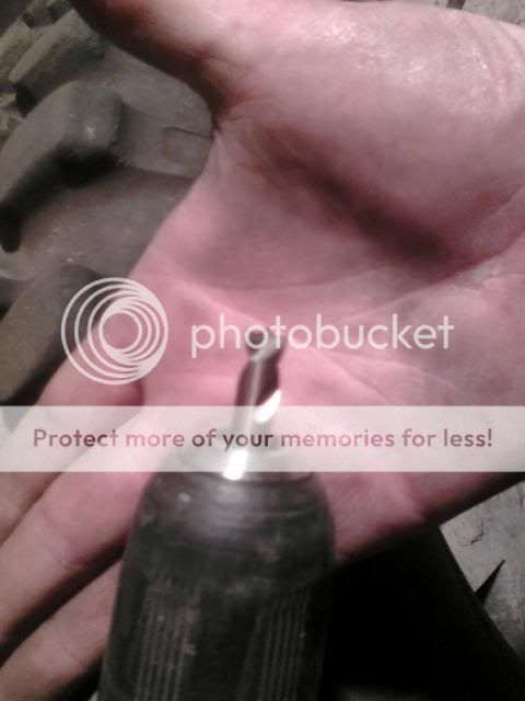

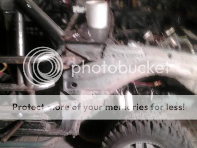

When I did it I removed the fenders, hood and doors. Then cut the spot welds with a special drill bit. The bit cost me $14.00 and drillling the spot welds took me about 5 minutes per side. I'll see if I can find pics.
The bit;
And a fuzzy pic, shows the holes drilled and the inner fender loose;

The pics are a big help too.
Nice cage !
