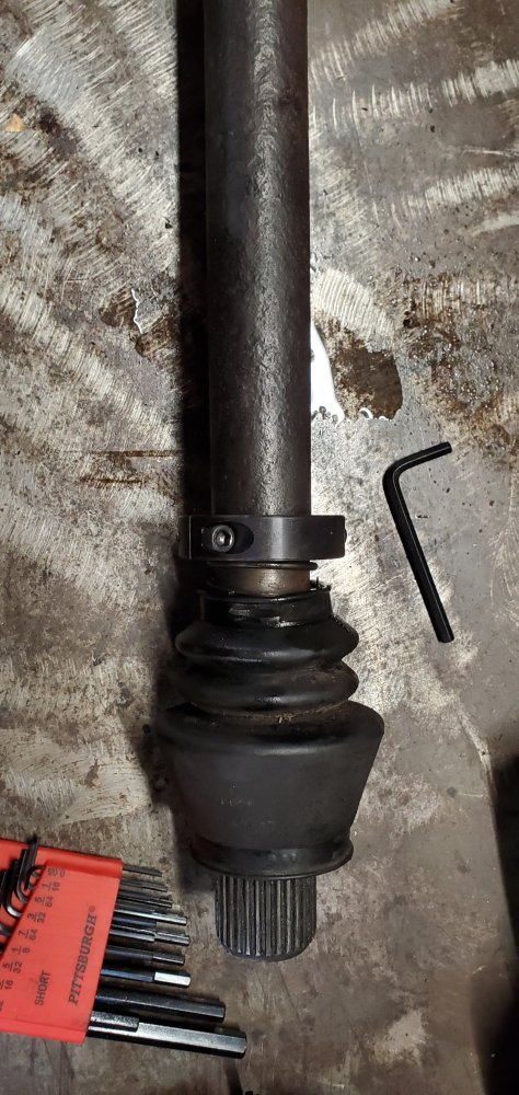

Same here, but I used a clamp to hold the spring.
That's way overkill, and I didn't want junk getting in the splines. I was skeptical when I just put the spring in the boot but it hasn't moved...
I did the same thing, but put the clamp inside the boot. It was a pain to install the first time. Had to use long bolts to get the spindle pulled up over the outer shaft.
