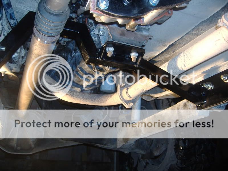

4x4junkie, how did you fab the radius cross support to fit the driveline below it?
Here is how I had mine.

Copykat pictured his transmission crossmember. Mine's the same concept except I made the tube sweep forward slightly rather than upward to give the shaft clearance for uptravel.
You should however be able to use your stock trans xmember IF the rear t-case is clocked up just a hair (I ran my stock xmember for quite awhile until I finally mangled it to s#!t on a rock).
