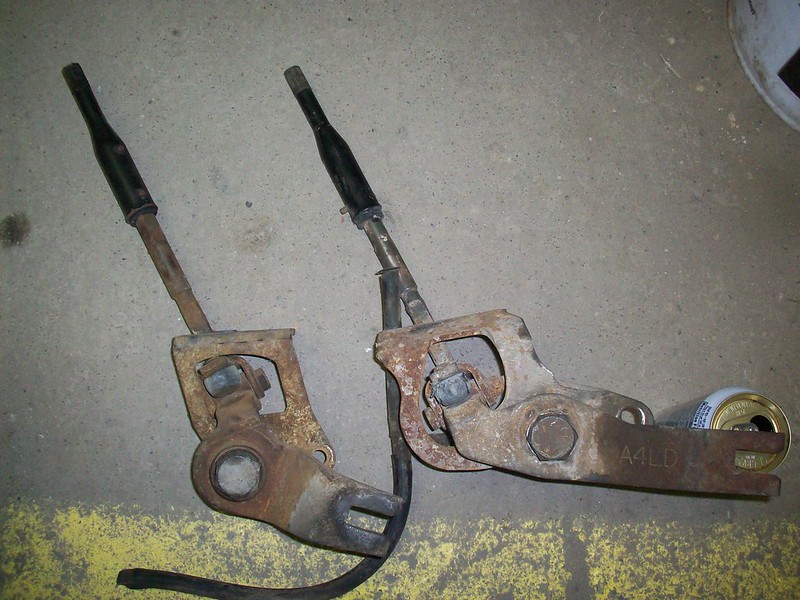

Hey people looking for A4LD linkage for my 1988 ranger. Just got a bw1350 transfercase but the linkage not the right one. I'm changing out from the old touch electric transfer. Nothing but problems with it. Any help locating this linkage would be great. Is there aftermarket?
No aftermarket that I'm aware of. Junkyard or build it are the only options.
How far off is the linkage you have now? It "might" be simple enough to modify. Pics of an attempt to install it would be awesome.
Have not tryed to install, I just know the one I have is off a 1984 ranger and won't work. Just picked up transfer case Wednesday. Think i will go threw it befor pulling my electric case out. Also has ujoint connection on out going and my ranger has the plate style ujoint conection? Hoping i can make something work there as well.
I didn't know the 1350 ever came with anything but a plate mount rear and slip yoke front.
Yes. I see many online with the ujoint comming off the rear of the transfer as the one I just bought dose. If I knew how to send pics of some I would.
Your 84 is probably the shorter one on the left, you need the longer one on the right.
And the little lever on the t-case can vary as well.
There is more on it here:
That's exactly what I need. Your correct i want to get assortment of parts and pc before diving in to it. My problem is my ranger is at my cabin 400 miles away. This is why I am trying to gather a bunch of these linkage parts before I tackle it. Thanks for all the info.
