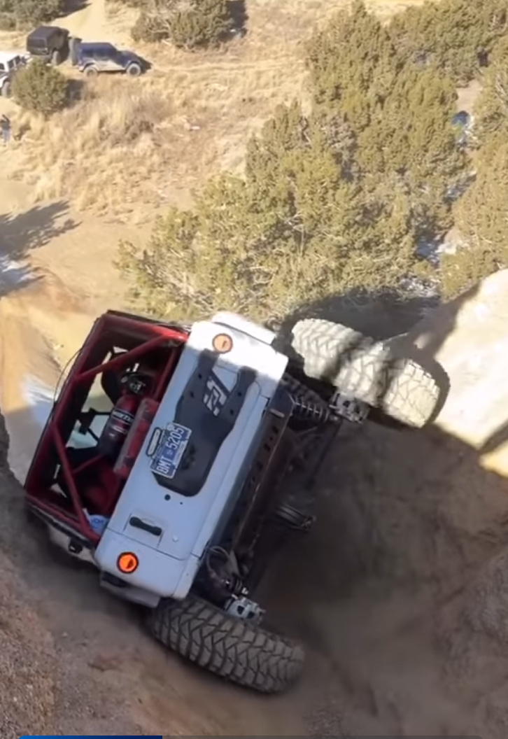

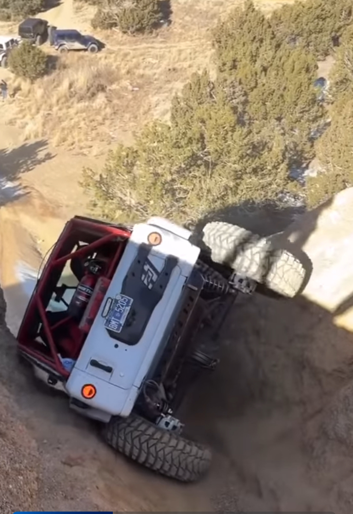

We just don’t want him stalling on a little hill like this on the next vagabond trip.
