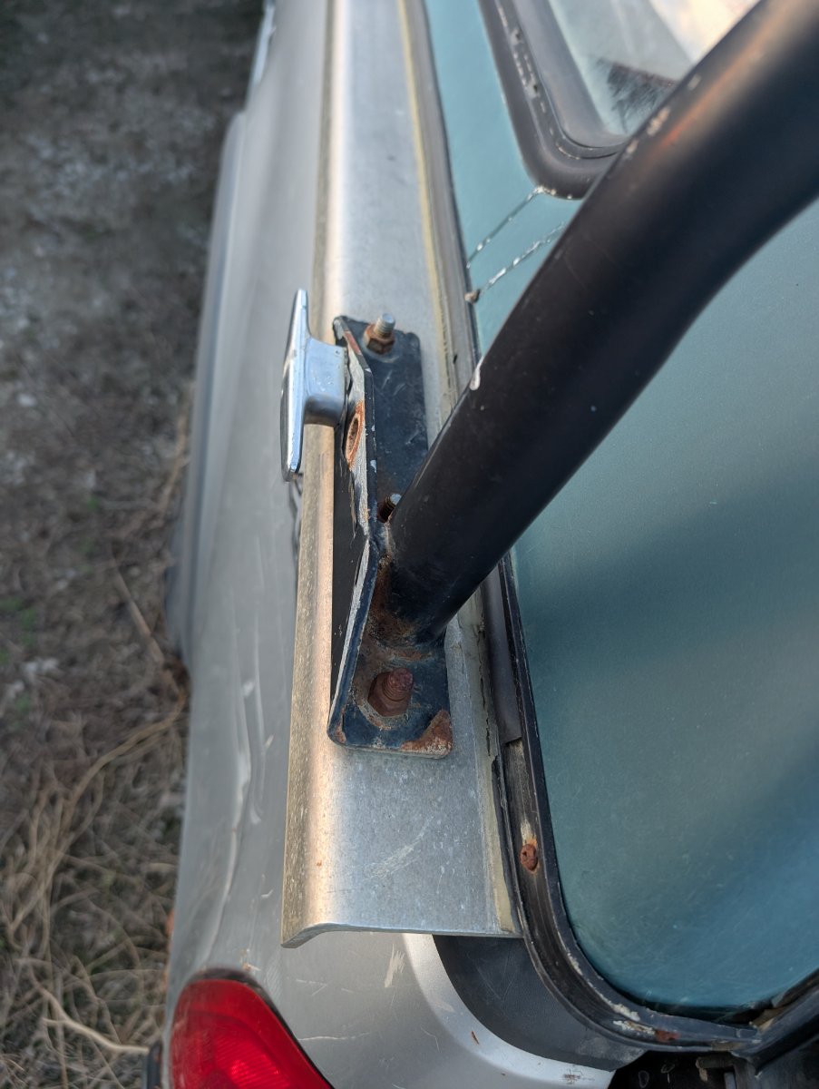

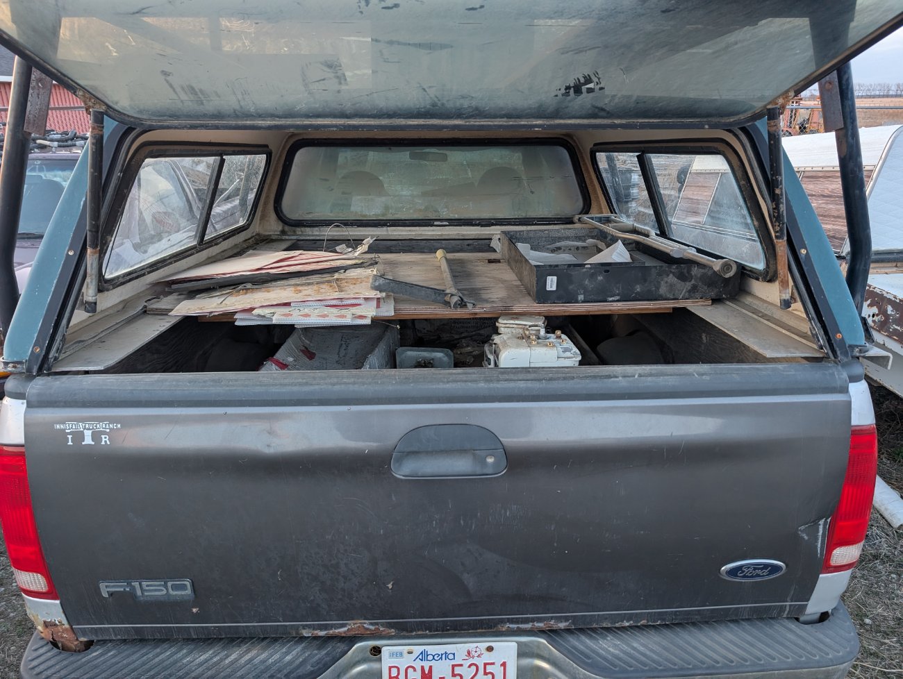

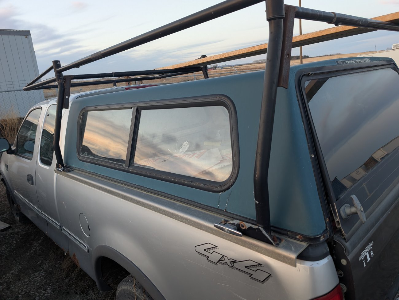

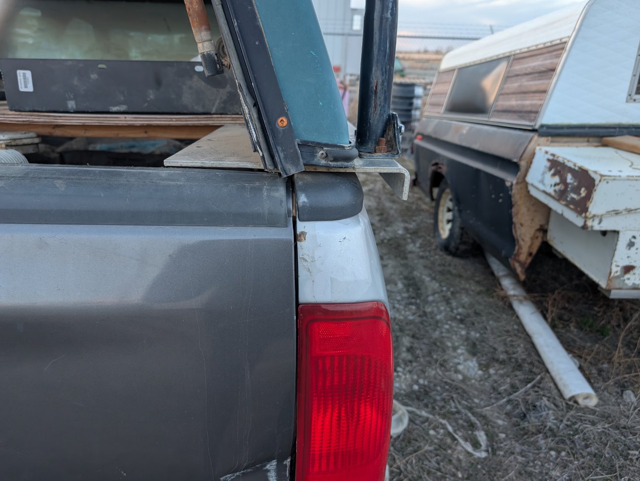

I've done similar to my f150 to put ladder racks around my topper. The aluminum sides were originally built so I could out a full width topper on my flair side bed and still use a ladder rack for my siding business. My ladder rack has been braced by welding in metal. I'm sure similar could be done for your use case.

This looks pretty much perfect, just wonder how the rack is affixed to the bed under the topper there. the tent weighs about 100 lbs and one or two people sleeping would bring it to about 400 ish so i need some good stability especially for climbing in and out
View attachment 142345View attachment 142346View attachment 142347View attachment 142348View attachment 142349View attachment 142350

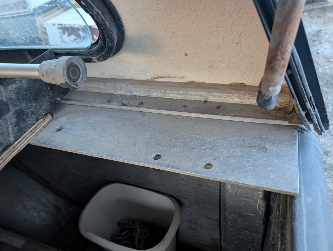

i like this idea, so the aluminum extensions are just bolted to the topper and then bolted into the bed rails?

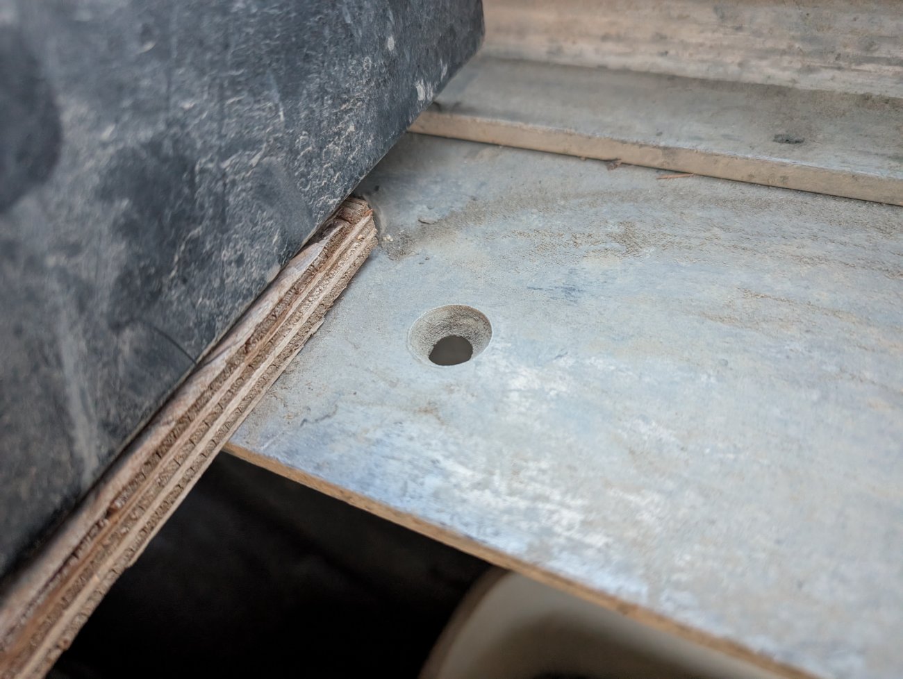

I bolted the aluminum to the bed rail first with bolts that have similar angles as a wood screw. In one of the pics you can see the hole drilled to accept the angled head. Once bolted down the top of the head is flush with the top of the aluminum. Then I bolt down the topper, then the rack. In a week or two I'll be putting that setup on my dodge truck. I'll take some more detailed pics then.

To make sure the legs don't spread over time, I would either bolt the mounting plate to the bed with tapered machine screws so the cap and sit flat on top and get a good seal or bolt directly through both the cap and the plate to the bed rails. It depends on if you want to use the C-clamps made for bed caps, which you already have, or just eliminate them. Regular bolts through both is probably going to be stronger. I just depends on how you want to set it up.
Either way, to make life easier on yourself for if you ever want to take the rack off, having the cross rails bolt into the uprights wouldn't be a horrible idea. And it would give you more room to remove or install the cap if you want to have the rack hug the top of the cap pretty closely.

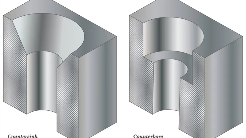

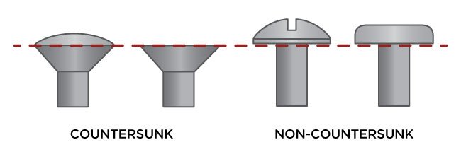

Officially called flat "countersunk head" because they're flat on top and the head is countersunk into the material.
Building an overland rack
Or, if your material is thick enough, you can machine a counterbored hole with flat bottom and use almost any "non-countersunk" head screw.
