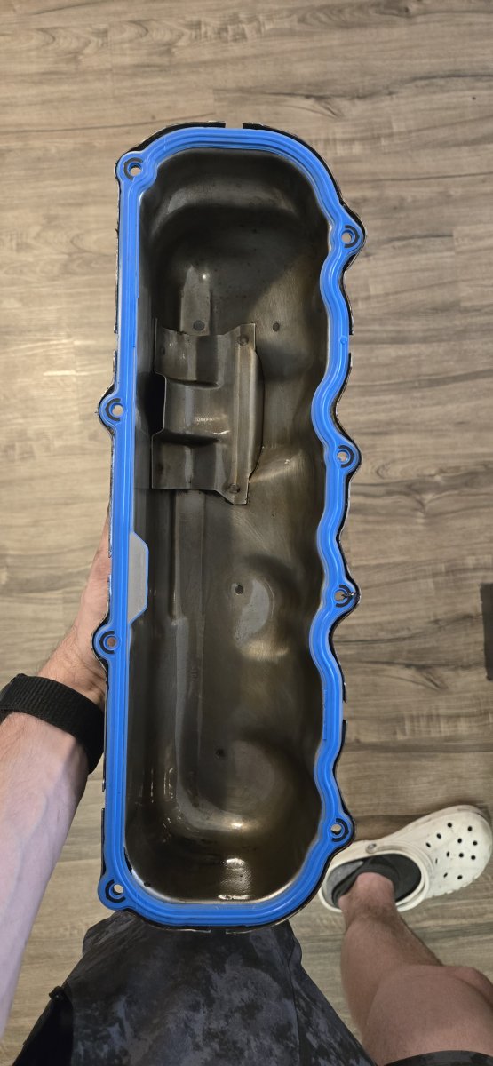

  • Valve Cover Gaskets
    • I used the Blue Felpro Gaskets from Rock Auto, seems to have fixed the infamous leak for now.

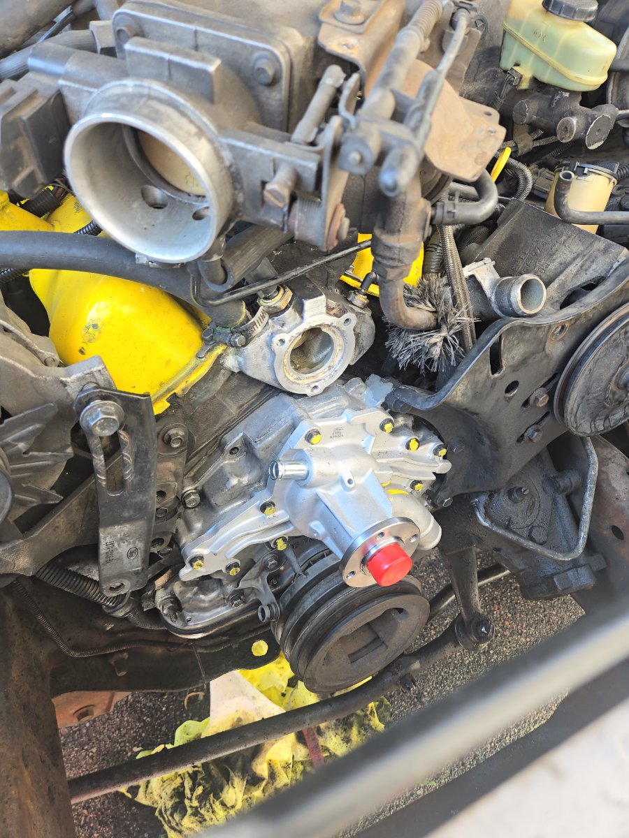

  • Water Pump
  • Water Pump Gasket

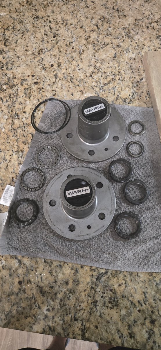

  • Warn Manual Locking Hubs
    • Replaced my functional Automatic hubs, but got a great deal on FB Marketplace.

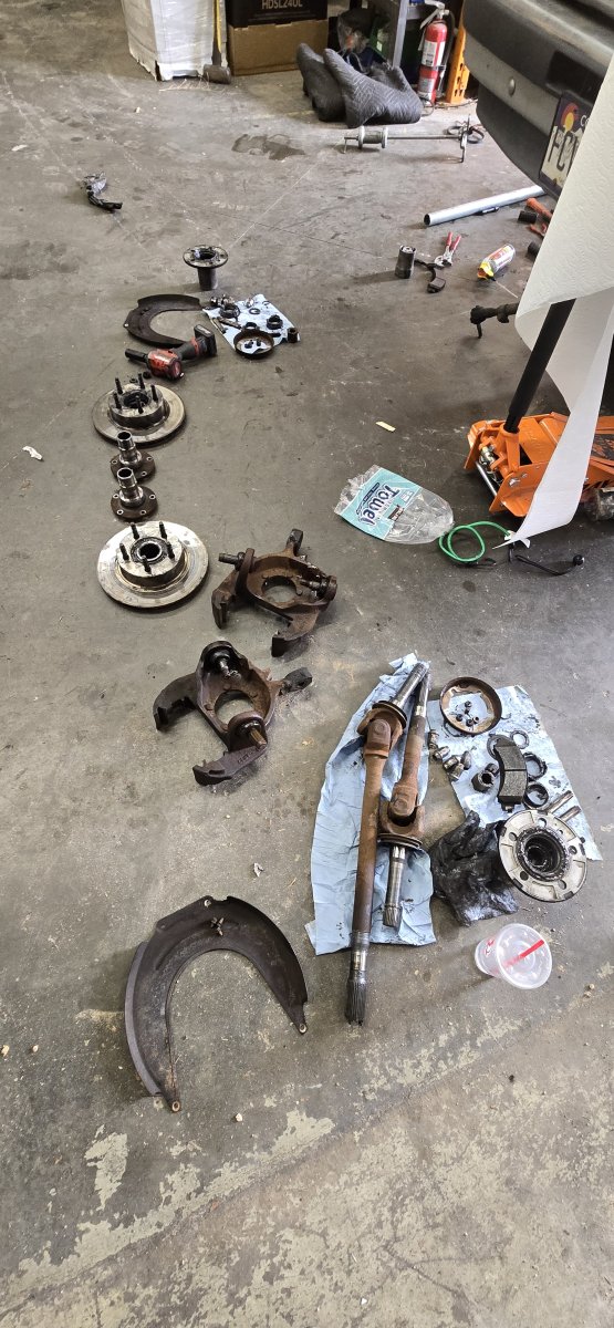

  • Front Brake Rotors
  • Front Brake Pads
  • Front Wheel Bearings
  • Front Wheel Seals

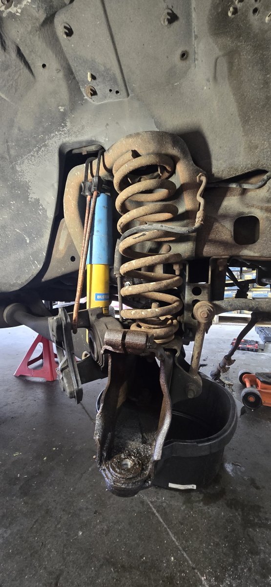

  • Upper Ball Joints
  • Lower Ball Joints
  • Front Shock Absorbers
  • Rear Shock Absorbers

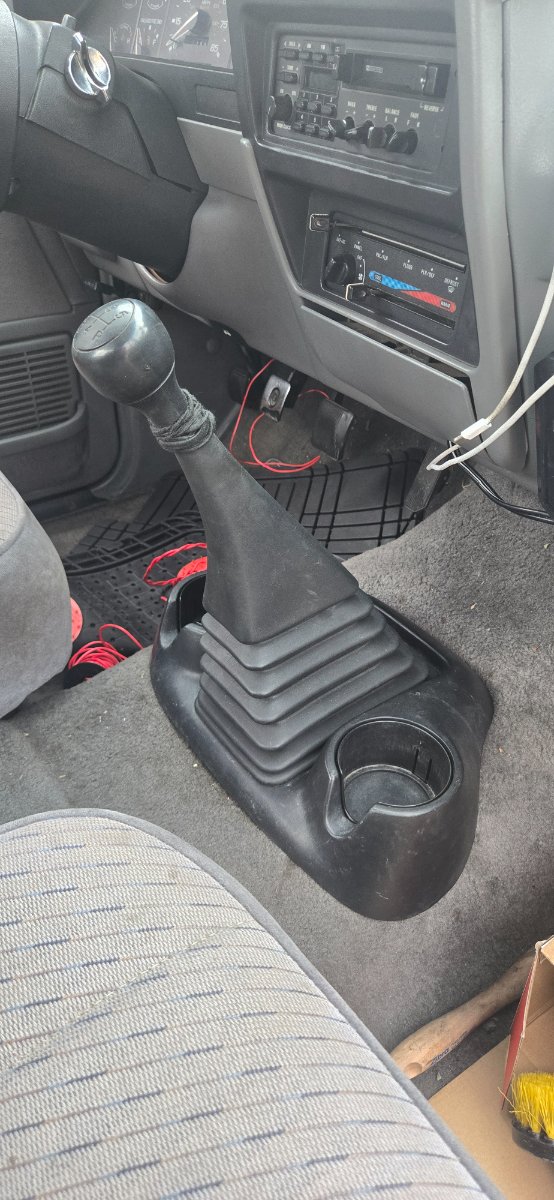

  • Center console delete
  • Shift Knob

  • Shift Boot with Cupholders

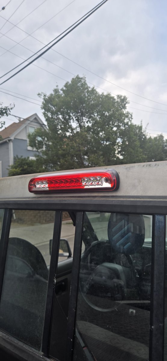

  • 3rd Brake Light Conversion

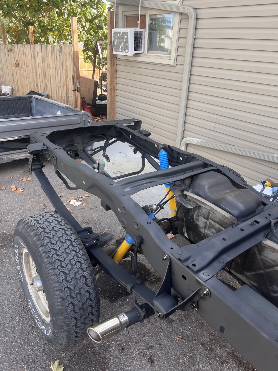

  • Wire wheeled, rust reformed, and undercoated the rear half of the frame
  • Wire wheeled, rust reformed, and primed the truck bed before liner install

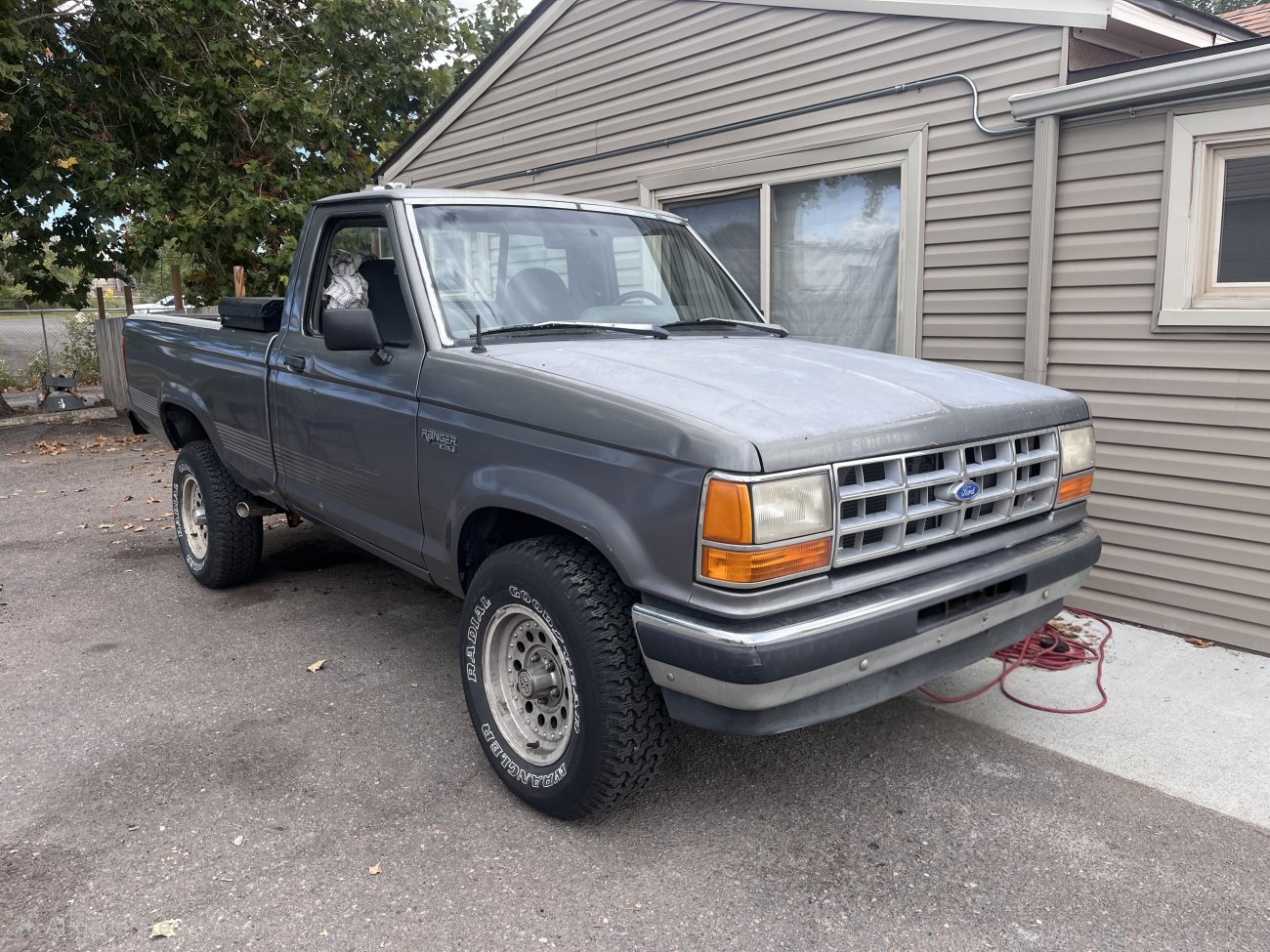

Looks like a VERY nice truck to save, AND you seem to be doing everything the right way. Awesome!
The Wranglers (Walmart?) look good on there. If you intend to keep the 4wd functional, a Dextero DAT1 (again, Walmart) is a solid option in 235/75r15, as it is an XL instead of an SL rating. And just a bit more aggressive, handles heavy rain better.
Add front shock boots. I have those blue/yellow Bilseins on one of my trucks. Good shocks, but the rod is corrosion prone.
Install a heavier duty rear spring pack set. 2+1 are barely adequate for a 2wd with a 2.3/5spd. Too much axle wrap during a one wheel peel on damp surfaces. A B2/Explorer rear swaybar is worth the sweat equity to adapt it while the bed is out of the way. Will be adding one, and a B2 style trac bar set, to my 94 2wd. Got spoiled by the huge (1.5”) rear bar on my 1t 4wd.

Wranglers are actually 14 years old, lol... pretty much brand new tread on them which is promising for the mileage of the truck I suppose. Coincidentally the truck is getting some new shoes this weekend, took advantage of Gigatire sale on these puppies. Not KO3's, but should be a huge step up to the current unbalanced, dry rotted, and visually bulging 14 year old tires.
Noted on the rear springs, this thing has been babied so far during rehab, but should be just about ready for some more interesting tests very shortly!
Those Armstrongs are NOT the TruTrac of old… Very soft compound. Thin above the bead, tear easily. Tire shop destroyed 1 mounting a set as steer tires on my K3500. They are a decent winter tire, not worth a hoot when it is hot out.
