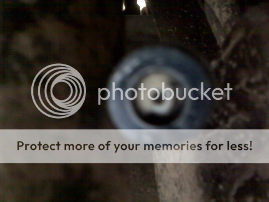

well i have took the line back off. and it looks like ther is a little white disc broken end of the line. Not sure if it was like this before or caused it. now side of the other piece.
I took a crappy cell phone pic of it. it helps.
if you apply pressure the master it does not come out the center whole but where teh broken piece is missing.
when hooked up the pressure is right at the floor and light at the top of course.
I bet that is your problem right there, most likley need a new line.
Last I time bought one new, it was ~50$.
You could get one from a junk yard for really cheap.
