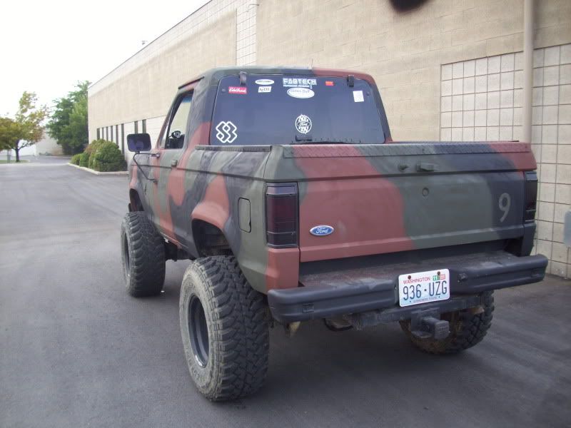

If you go with option #1 I would be happy to answer any questions about how to do it. Here is how mine turned out.
Bronco 2 choptop sealed cab options.
Hey Rico, saw your rig on this site before and like the way you sealed that off. I think I read that you used a b2 hatch? Also do you have any pictures showing how you sealed the sides inside the cab as well as the bottom? Also how much of a PITA was the whole process?:dunno:
Hello from Medford. One consideration is whether you want to make a pickup out of it or to use the rear seat. Wanted to keep the rear seat so I did 1 and 3. I can remove the window and install my soft top or put the window in and use my soft tonneau cover. If you're ever in Medford and want to take a look, let me know. Norm
I like the soft top idea...but then again Rico's chop looks awesome with the hatch
RICO's is probably the best chop I've ever seen. But I vote option 2.
