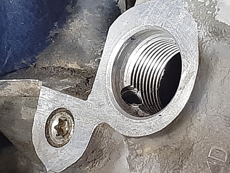

If Gasket\Seal\Washer around an OilPressurized TimingTensioner, either LeftFront or RightRear,
is not carefully centered as Tensioners are snugged up,
or if Tensioner~Head seat is scratched]\gouged,
oil will spew out around Tensioner like blood from a stuck pig.
Oil Leak from LeftFront Tensioner, can quickly fill EngineV, then run back & down over BellHousing, a big mess.
Click here for more info on installing those Tensioners.
