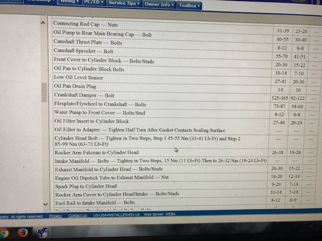

Well to anyone interested, I found out why I broke 3 head bolts.
I'll just leave this right here. Hint: check spec section. The giveaway is the thread starting depth.
29328

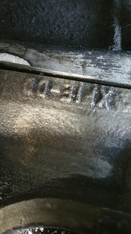

For those who didn't want to look it up, my block is early 1999 but my truck is a '96. Instead of a 2 step process, it is a 5 step process. Coming nowhere close to 70 ft. lbs. How the passenger side worked is beyond me.
Well that solves one mystery.

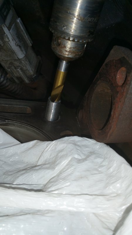

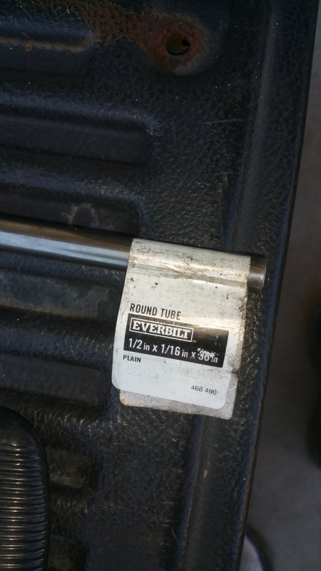

I'm working on it today. Had to get some 1/2" tubing and grind to fit for a drill guide. Slow going, but this should help
me drill straight at least
Heaps and heaps of good luck to you.
You have the right idea... slow and steady
Use lots of lube
are you using a reverse twist drill bit?
No. The left handed bits aren't strong enough. The bit in the picture above is titanium and barely makes a dent. Got a cobalt bit at Grainger last night and went through the bolt like it was butter.
That sounds like progress

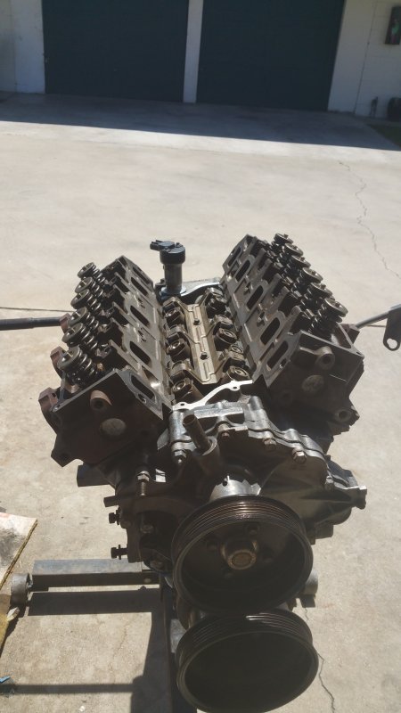

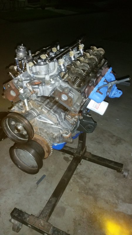

Here's an update.
The hole with the insert was out of round. Some idiot couldn't drill a straight hole. (Looking in the mirror). I just kept adding layers of jb weld until I was able to drill and tap for the helicoil. After using the proper torque procedure, it felt strong and smooth. I added some red thread locker when I installed the insert just as insurance. I'll let you all know what happens when I get it running.
Well I'm hoping to drop this in next week. Get to babysit the grandkids this weekend. My wife is getting anxious so I'm skipping some of the details I wanted to do but it will be good enough if it runs well.

Why... uhhh... did you paint your exhaust manifolds blue?
