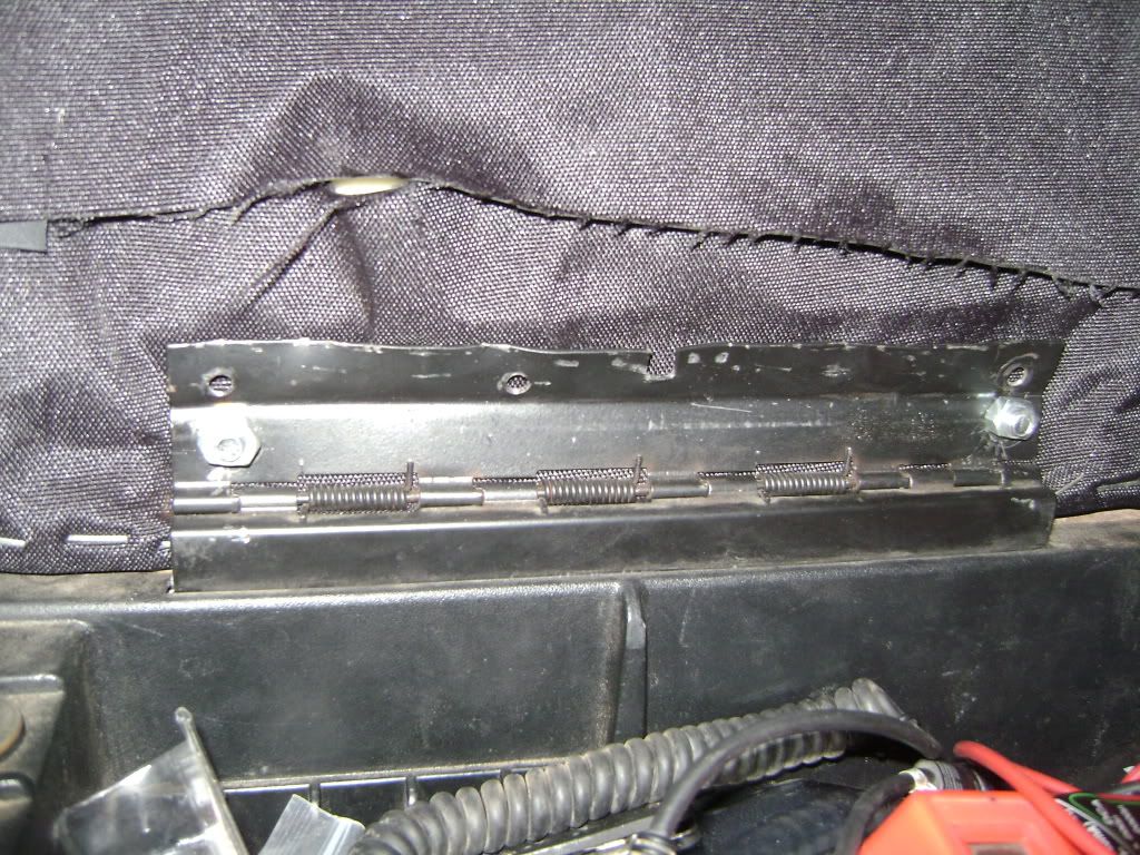

well I made a whole new cover for mine made of 1/4'' alum. and covered it with High dense foam. but for my latch I took a metal dowl thread one end and made a notch in the other. then all you have to do it tap the lid for the now threaded dowel.

I started with a plate of alum. found a cheap piece that I was not going ot bend or break when my Mastiff walks on it. getting in the truck.
I then took the plate and laid it down on the console to get the proper shape. cut it to where I liked it.
I then had to bend the hinge flat to and marked the whole to drill on the plate. did this a few times till I found the postion that would alow it to open all the way with no interferance.
After getting the hinge and plate in postion that I was happy with I drilled a hole where the latch section is and taped it. I then took a Dowl of alum. and notched it to fit in the latch. (not very pretty but it works) but at this point the lid had a 1/4inch jab between the lid and console and in AZ the alum. lid gets hot as hell. So I took the 4 sheets of High dense foam and glued them together with 3m spry adhesive then glued them to the top of the plate. trimming the foam to the shape I like on the edges and from there I bulit up the foam along the bottom of the plate to close the gap. I then wrapped the finished lid in a heavy duty semi waterproof canvas.
