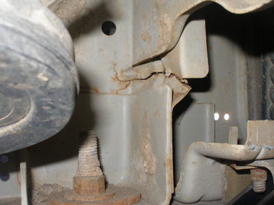

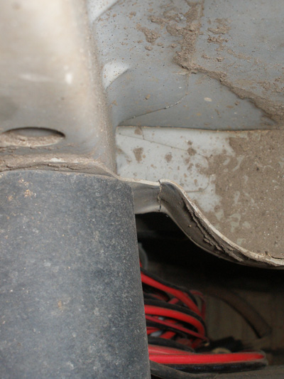

Under hard offroading your body lift will fail, mine did. I have the performance accesories 3in body lift. I tore two of the cab mounts on my truck. Now granted the cab is still fastened to the frame but i dont trust it.

My Ranger did that on the rear cab mounts and I have no bodylift on it (it was pretty early on it happened, too).
It seems mine was the result of the spot-welds breaking (someone doing shitty work some days, or not prepping the metal correctly). I drilled out the welds and put some bolts in along with a few various pieces of 1/8" steel to reinforce the area, and have not had any problems there since.
