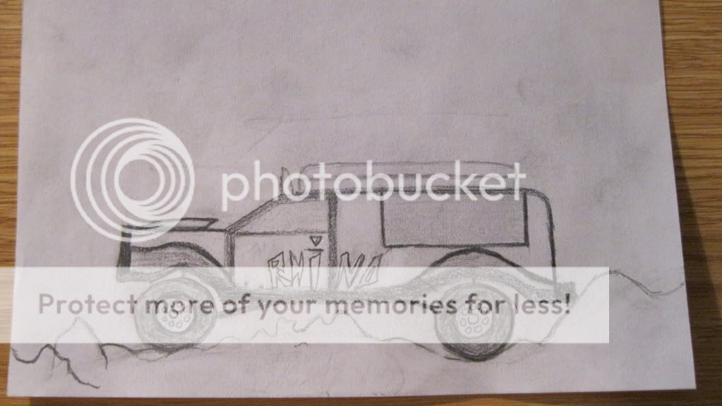

Its still on the drawing board but the basic idea is to attach it to the roll bar through a series of clamps/slides.....im gonna use some ideas from a samuri I grew up with, the slide clips work pretty well.. Basically Im hoping with enough seals and clamps I will be able to use the original top and not have to cann. material from a donor.
Got bored while studying and drew this....

enough people chop b2s and mold ranger bed rail caps onto them i dont think itd be very hard to do the truck half. then just weld 90 degree angle iron to the bottom of the roof where you cut it off. then use the regular c clamps as if it was a pickup with a cap. run some 1/8" foam stripping between the bed rails and the new "cap" and it should seal up real good.

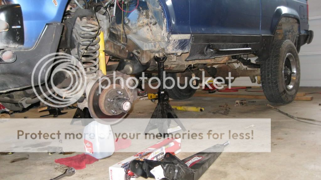

So im back in Wv and got the Blue Rhino in the garage and up on jack stands. Been workin on the lift kit, got the rear springs on and then got annoyed so I switched to the front. Ill prob finish it up this weekend. (well attempt to haha)

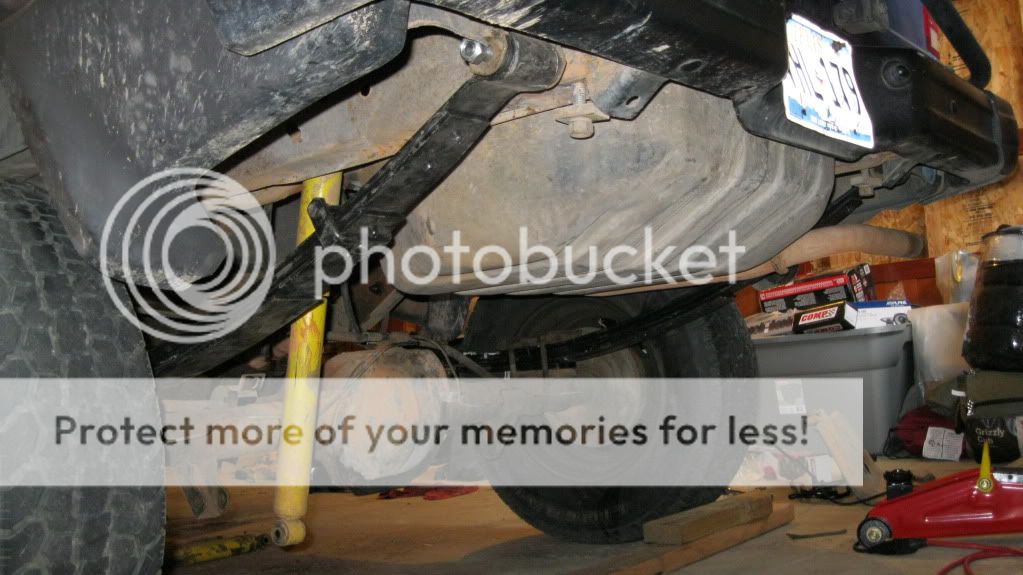

Just the leaf springs on no shocks,]...well ths stock shock is still hangin gotta drop the gas tank again. . .

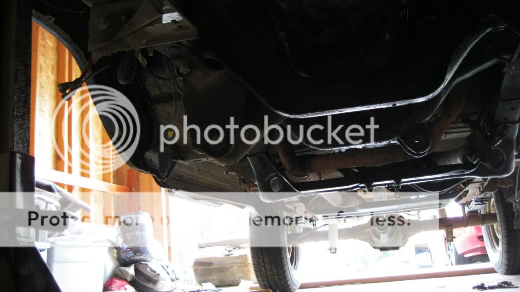

The back is sitting pretty much at ride height!

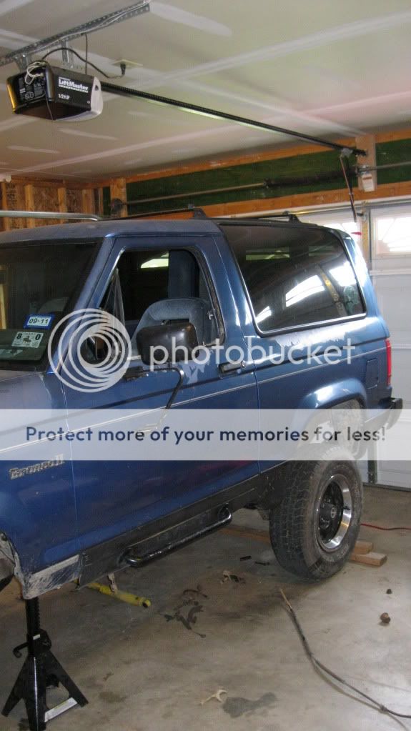

ride height with stock tires onle gives me about an inch or clearance in the garage, one the 35/12.5x15 TSL Boggers are on there it will have to stay outside!

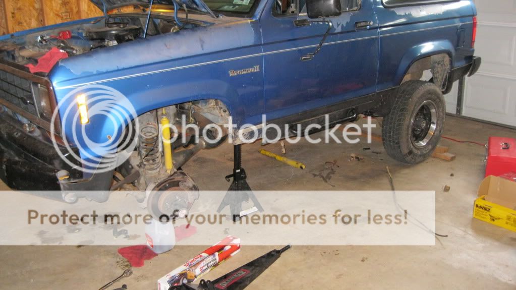

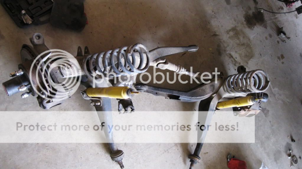

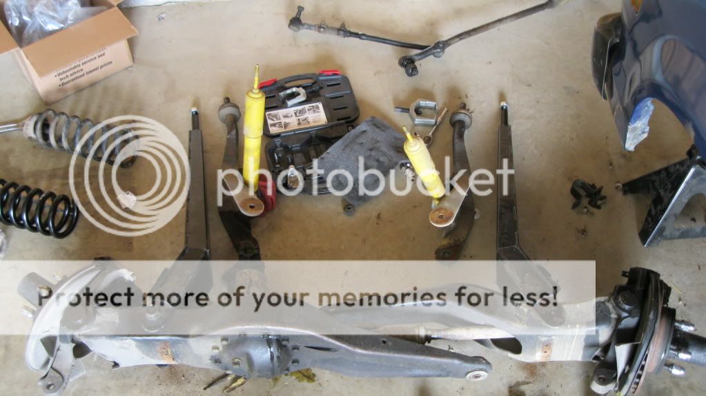

The front is comin apart pretty nice so far.

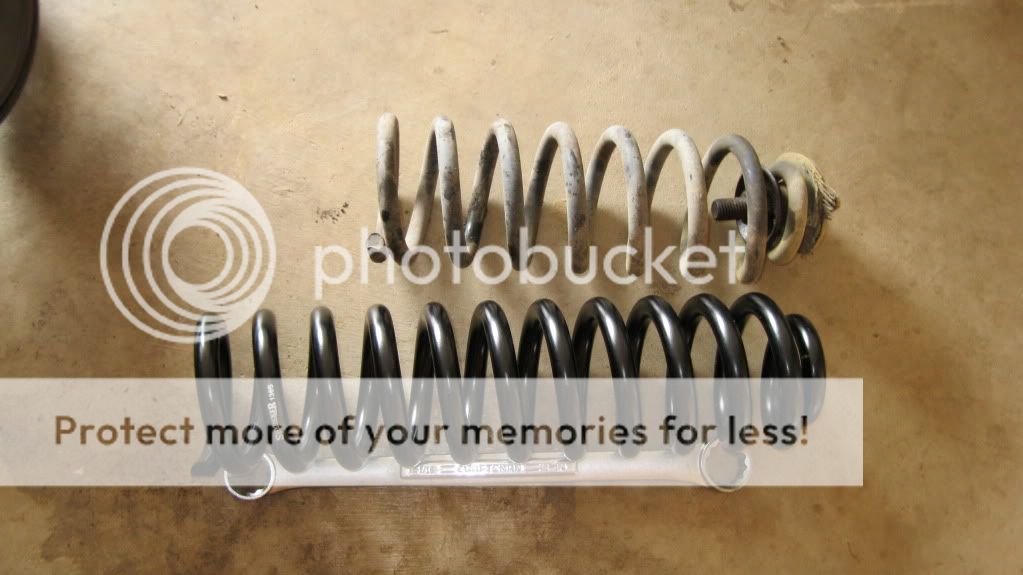

Worked on her some yesterday, need some locktite, gotta get some today and then continue the work:

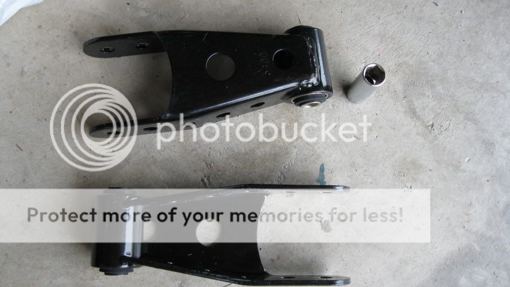

First I got the new Beltech 6400 shackles, though they will have to wait till the front end is back on

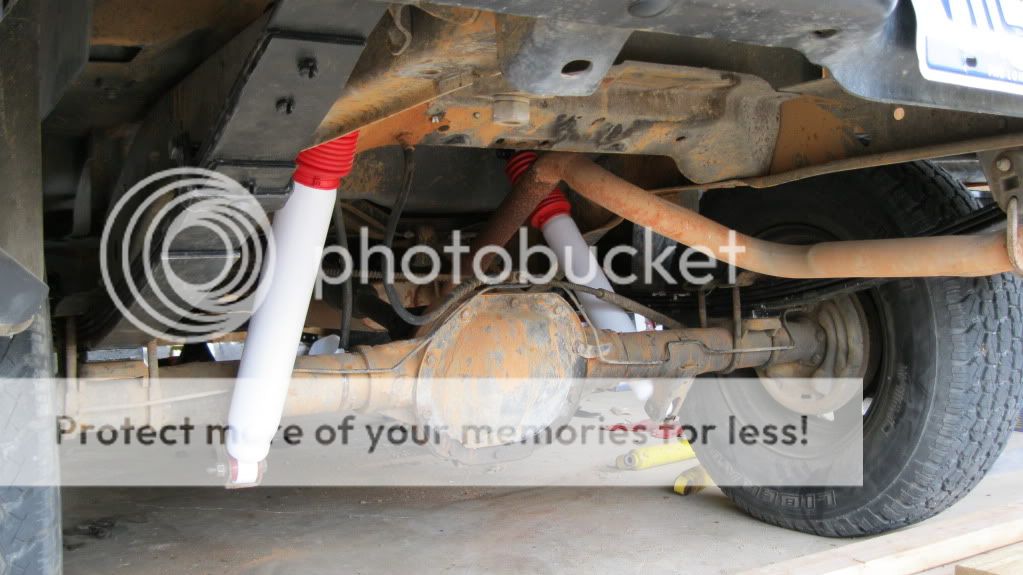

Shocks on the rearend:

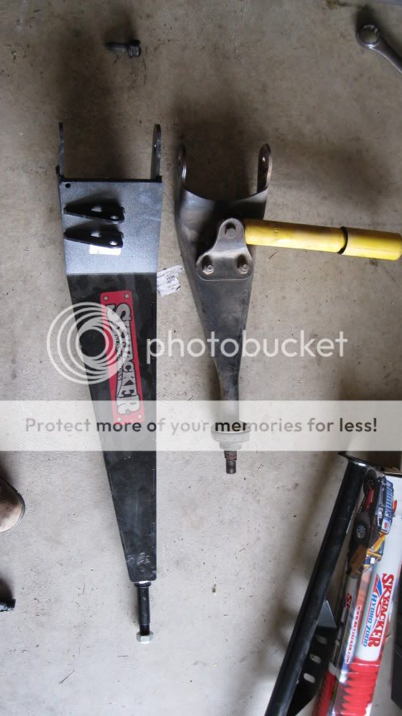

The new hardware is huge!
Anyone have any Ideas on how to get the stud outa the springs, its an 1, 1/8 size nut on both ends of the stud. I dont have a deepwell socked and the shorty wont go over the bolt, Ill prob end up takin it to the mechanic and haven him take it apart unless I get some other Ideas from yall.
