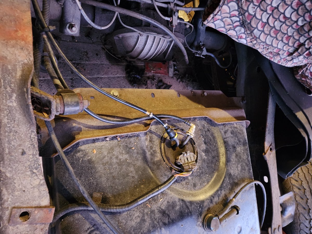

Aux. tank assembly with the Mark VIII fuel pump and float/sending unit.
is there a reason you used the mark 8 pump? why couldn't I use my pump (from the tank I have now) and shorten it by means of the 3/8" rubber hose?
it could definitely be done.

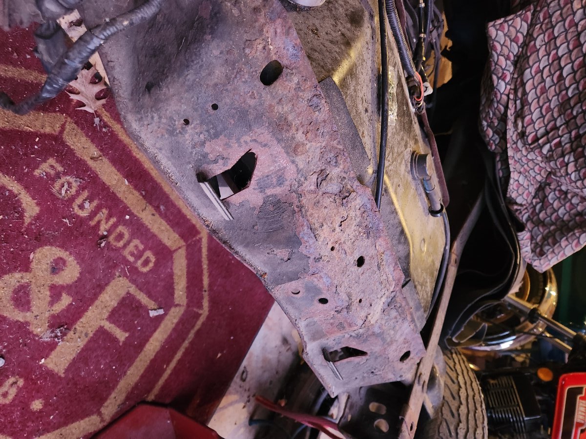

on the rear crossmember all you'll need to do is cut holes for the straps, they used that same rear crossmember all the way untill '97, just didn't punch the holes in it after '89.

Here's your pictures, at least this is what I hope you were looking for.
