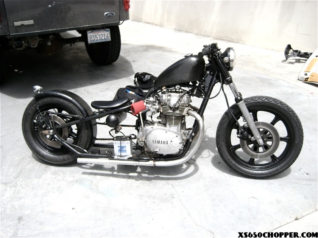

So where do I begin! I got back from college around May 15th and I had trip planned with my friends to the Black Hills, SD. So you all know of the bike I bought awhile back and I told you I wanted to make a bobber out of it and that is what I did.
First was to cut the frame and weld on the hard tail:
Next I set my springer seat and tank:
Then I gave her a bit of paint:
Then the wiring and shes done!
The bike build took around three weeks.
