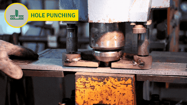

Find someone with an ironworker that can just punch a hole through it.

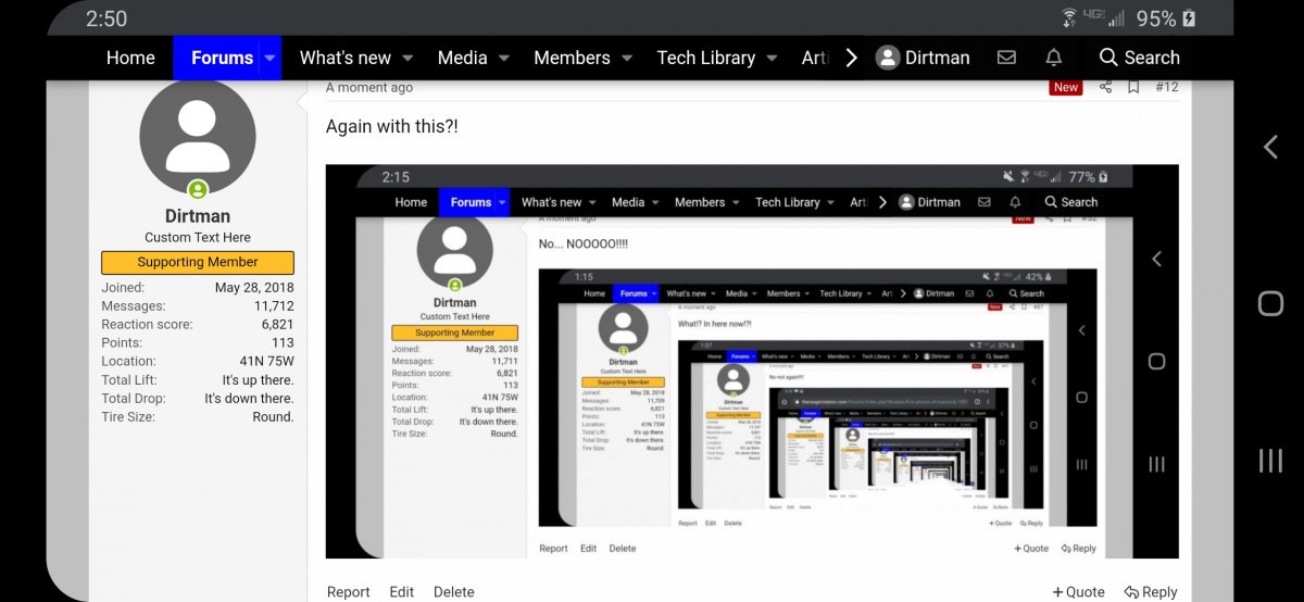

Oh god when will it end!
