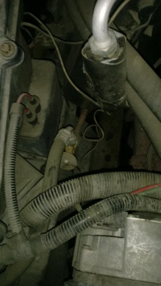

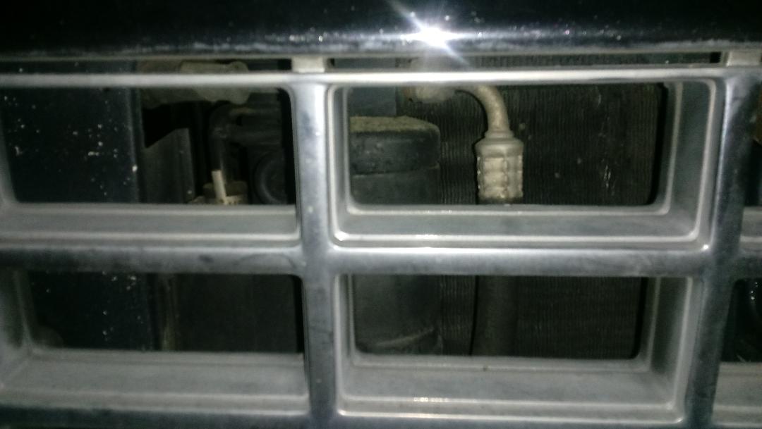

This AC looks to be the dealer added system as the accumulator and that stuff isn't up by the evaporator area where it normally is, its up in front of the radiator. The AC does work, had it running today on the way home from town.

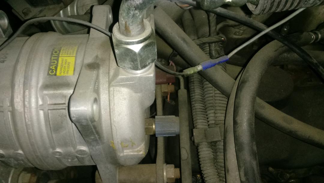

It is R134A, both the high and low side ports are on the back of the compressor not in the lines like I'm used to seeing...took me a bit to figure out HAHA.

Nope, not a bad truck for being 30+ years old. AC has been converted to R134A, so not sure how that's going to hold up, compressor looks relatively new (re-manufactured unit), and the suction and discharge lines look new as well.

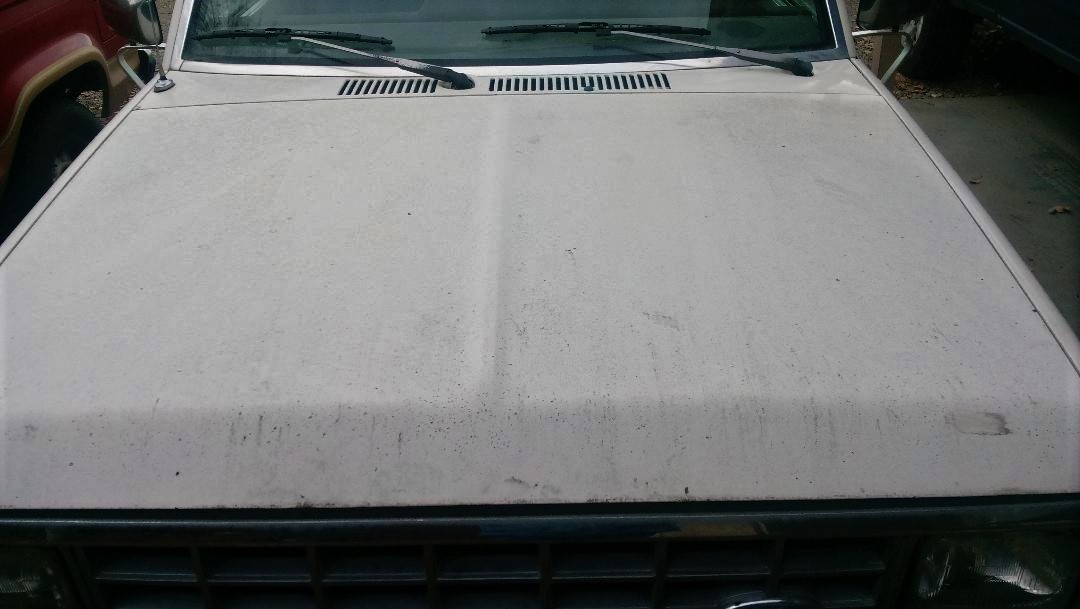

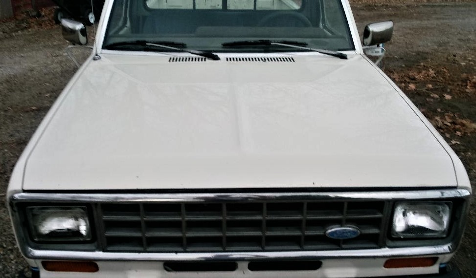

I got the tree sap and grime cleaned off the hood and cab roof like I mentioned earlier, so that's a plus. It looks better for sure, and I pulled the bug shield off, I think it looks a lot better without the bug shield...I'll take the bed mat out too, don't like that flopping around back there on the highway it makes it look like its going to fly out.

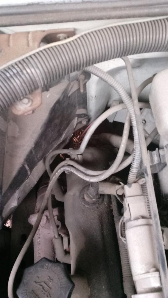

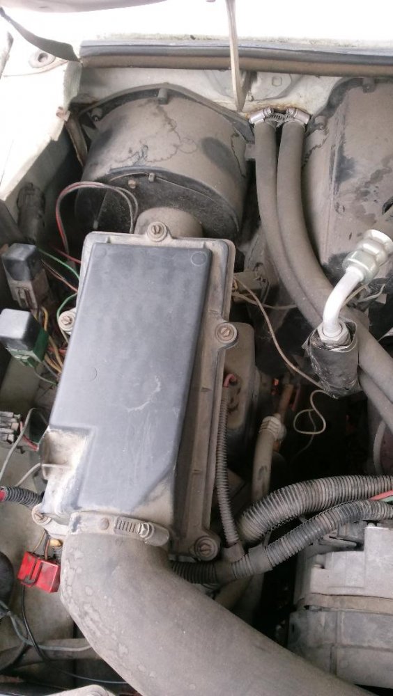

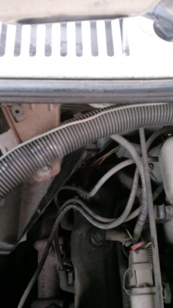

Looked around and didn't see anything unplugged or otherwise, I can smell a little bit of fuel from the fuel pressure regulator vacuum hose which I've read is a sign that the regulator is bad but I don't think that would cause my chugging and power loss problem.
In the second picture, what I'm looking for is just out of the frame, to the left (towards the right fender). If my memory is correct, it's about as deep as the exhaust manifold (seen in the picture). It has two hoses (3/4 inch approx) coming out of it at right angles.
Not sure, there's nothing more over there on that side other than relays...this is also a 2.9L fuel injected V6 not the 2.8L V6....you may be thinking of the exhaust re-circulation tubes that would run from the exhaust through the air pump (smog pump) to get reburned...my truck don't have any of that, sadly it has an EGR valve though. There aren't any other hoses or tubes over on that side except the air box and air inlet.
