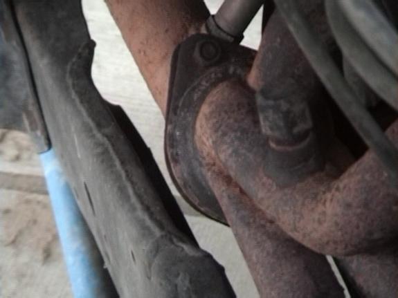

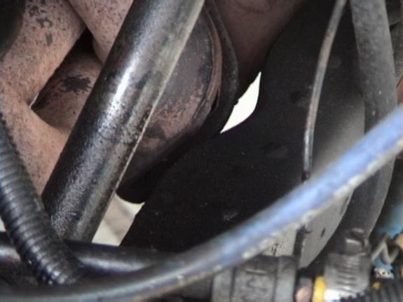

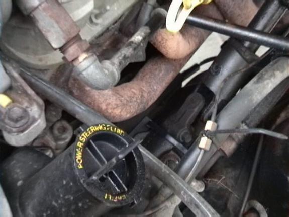

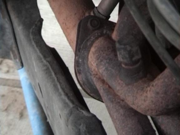

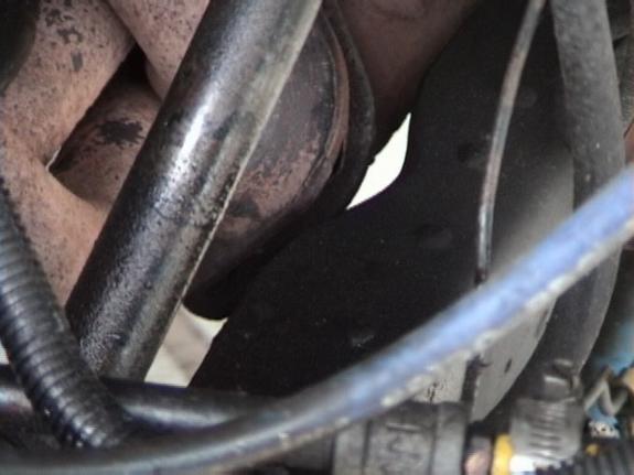

My truck had the rag joint at the top of the lower steering shaft and it would have rubbed on the manifold. I replaced it with a Borgeson universal joint. I didn't have any problem with the mounts. Unless you're going for top end hp, I don't think headers will gain you anything but noise.

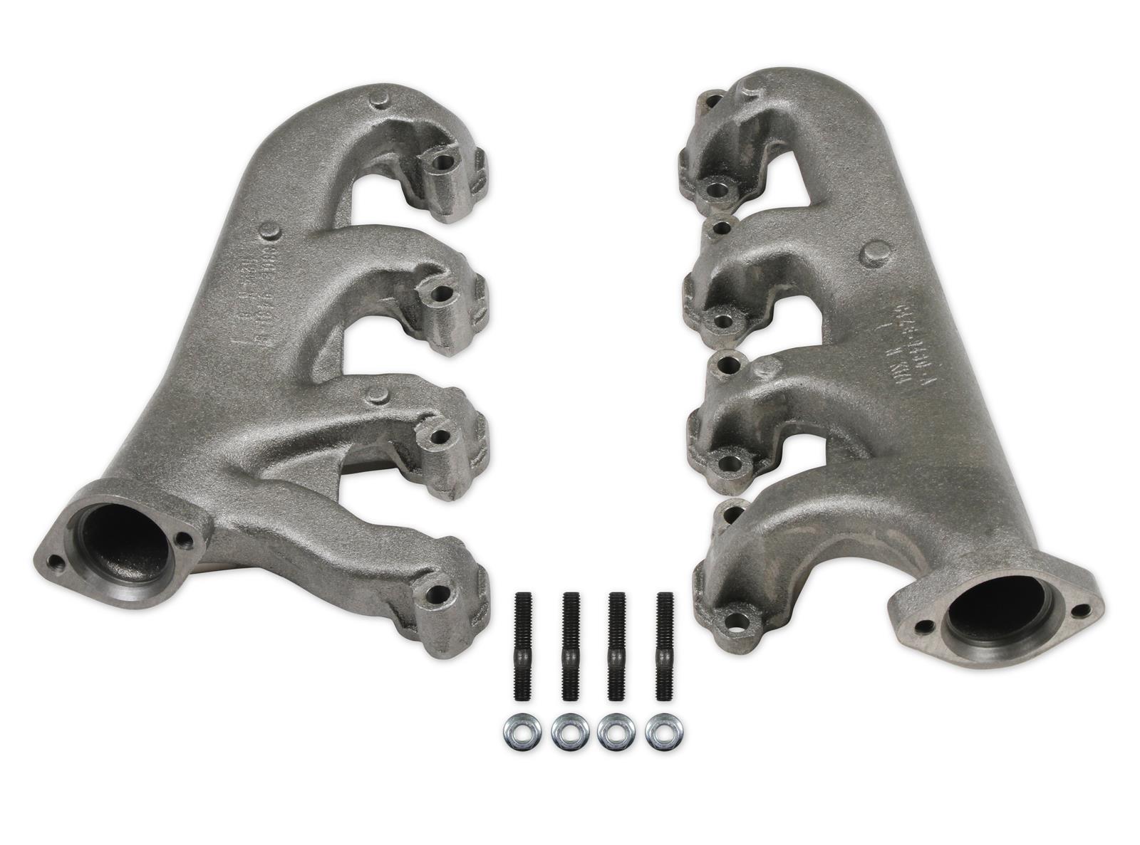

those 351 cobra R headers work really well and were made under a different number for some time....which i found out recently.
but k code stuff is much better then granada and will accommodate p heads....
to me its the simple option unless your going for over 380 wheel.
i was hoping to find pics of redirect for sla but so far not.....these pics i found trying to get some together for the ugly truck thing....
at the end of the day...screw those obx headers if your just wanting to go....get the k codes and make em fit or the normal shorty ranger headers and redirect the steering.
