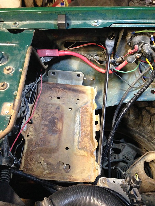

First gen battery trays generally don't age well, this is how I fixed mine.
I started out with this beauty.

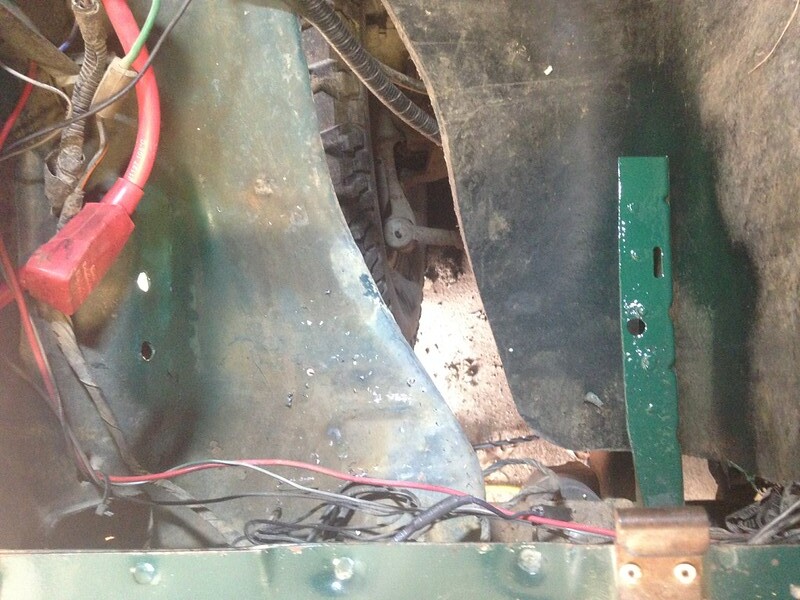

I got all that removed and cleaned up.

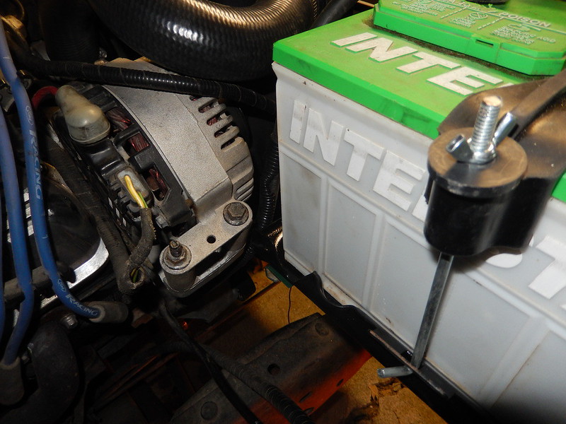

Do watch your clearances, I had to grind some on the corner for the tray to clear my alternator (302 with 96-01 Explorer accessories)
And now I can fit a 65 class battery. I had to be careful on the mounting as the clamp ends up at the front and will easily disappear under the radiator support.
