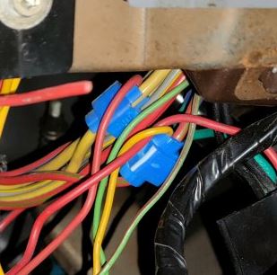

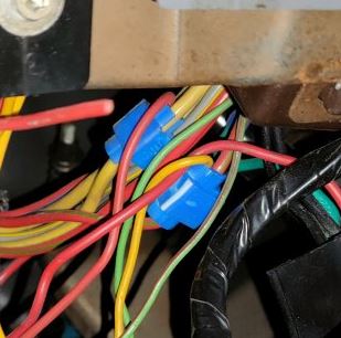

Check your connection point(s) for the camera, too.
If you used a SctotchLock type quick-connector, those can cause issues, especially after some time.

When we talk about your camera connections, we are blanketing all camera connections - power, ground, image signal and reverse trigger signal. All the wiring for the camera system.
I also agree about those scotch-loc connectors. They are pure evil.

Scotch-Lok connectors "bite" through the wire plastic insulation; in theory the copper wire nicely falls into a slot in the connector's metal blade. But usually the strands get some damage, being nicked or severed. Another factor is that a Scotch-Lok isn't weatherproof; over time air and moisture causes "green rot" in the copper strands at the connection. The green rot eventually reaches a point where the copper wire fails as an electrical conductor, or even breaks.
The insulation may not break, but downstream after the Scotch-Lok the circuit will be dead as a doornail.
It's something worth checking, even if it just eliminates the connection from the troubleshooting. And, it is a common factor between the B/U lights and camera, both of which are not working.

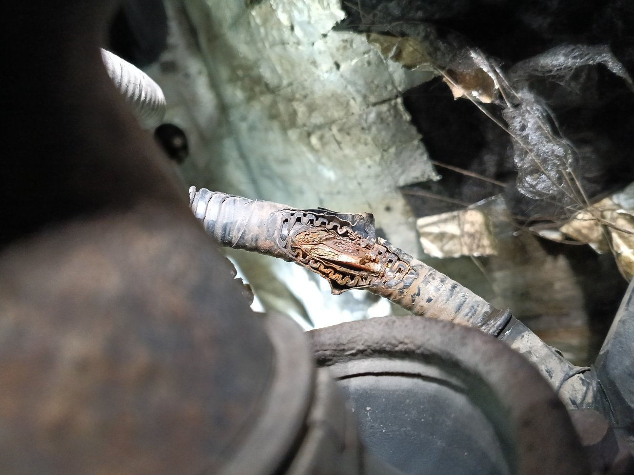

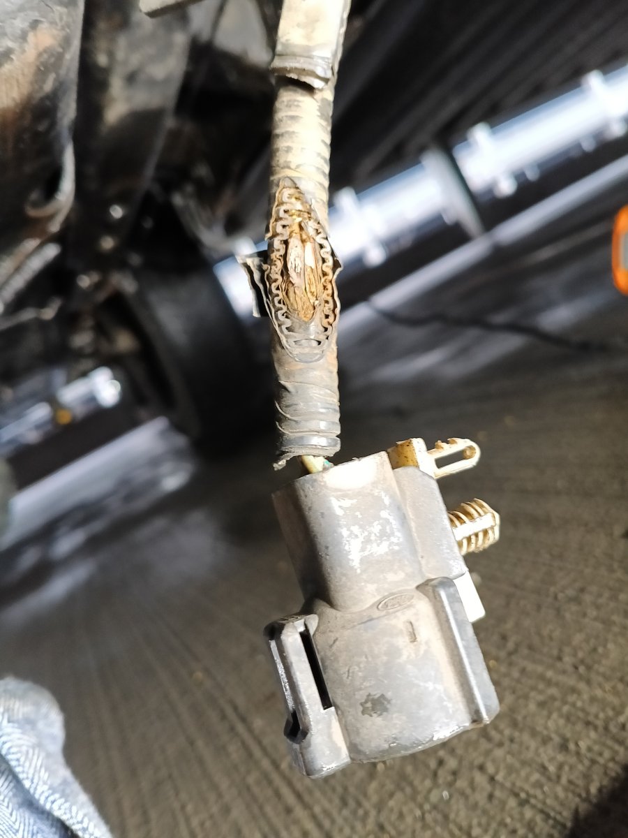

Well, I made Good progress. I think this may be my problem. I haven't tried to see if I have power out but I verified power In.
I guess the 12v input wire just didn't get affected but the other wires did.
I need to find this connector and solder it on.

good find.
sometimes a thorough inspection is what's needed. I liken that to exploratory surgery.
that harness looks repairable with butt connectors, due to the location it won't be easy.

Actually, when I pulled off that connector. It's thend leading to the vehicle away from the transmission and I have around 1-2 feet wire I can work with.
I'm gonna check Spaldings to see if I can find that harness.
