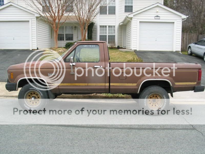

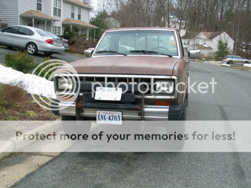

PICS!
I found some spots where the tires have been rubbing the wheel well liners in the front. So it'll probably get a body lift in the spring. Along with who knows how many other things.
Also think I may have the transmission noise narrowed down to the 4th gear needle bearing. Anyone know if there's a manual for rebuilding the FM trans online somewhere?

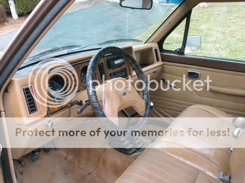

Looks just like my dads truck on the inside and my dad has the same rims only his are chrome.
BTW does the A/C work in your truck?
Another goody to add to these trucks are the intermiten speed wipers. Just find a truck with the wiper switch that has it and its a plug and play thing.
Why does that truck look familiar to me...? I swear I have seen one alot like it before.

The intermittent wipers are great. Have those on my 84 XLT. Gonna swap the whole column from that truck into this one. I like the horn being on the turn signal stalk.
My horn dont work, my tyrn signal switch came off a truck that didnt have a horn on the switch, dad needed a quick fix at the time (it was his truck). I want my horn to be on the steering wheel.
The one thing I wish my truck had was tilt steering.
The "tilt" steering on the older trucks doesn't do much. I think my 84 has it, but I don't ever use it.
