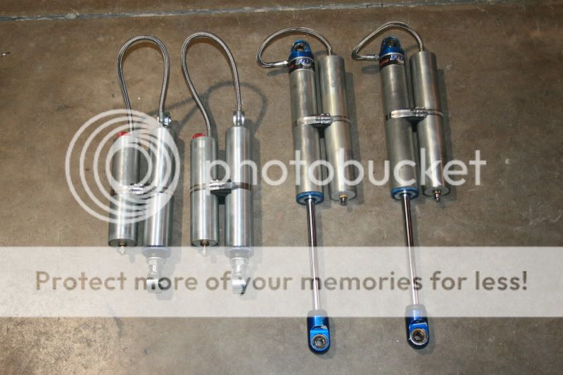

I got my rear fox shocks today. Thinking of getting a factory LS and 410 gears. Its kinda a dog with the 31's. I could use the extra traction too.

Small update. Got all my Fox shocks in. There used but will do the job. Ordered some urethane bushings and resi tank mounts from ORW. As soon as they come in shocks go on.
~Shawn

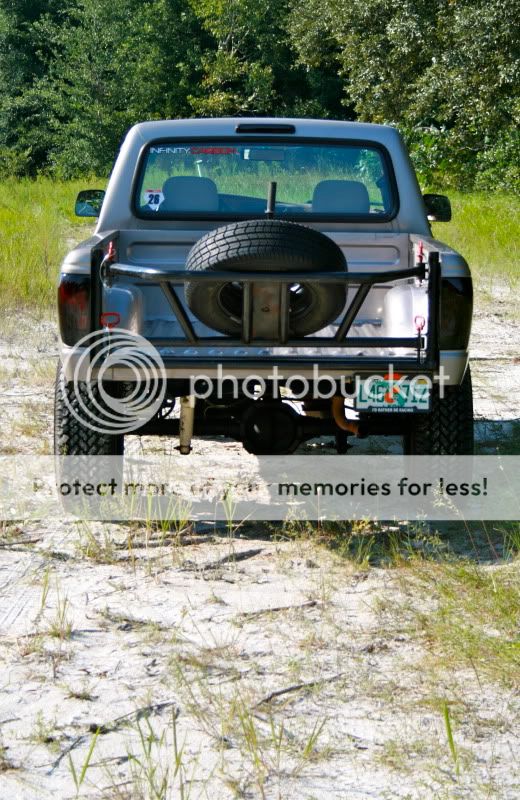

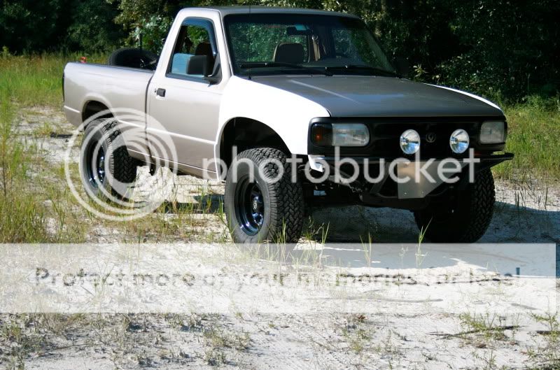

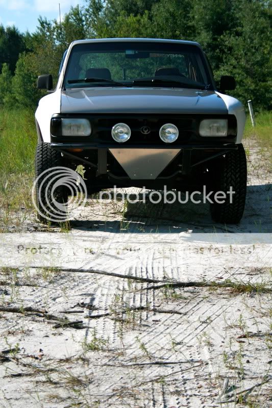

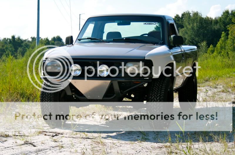

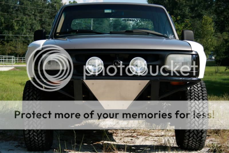

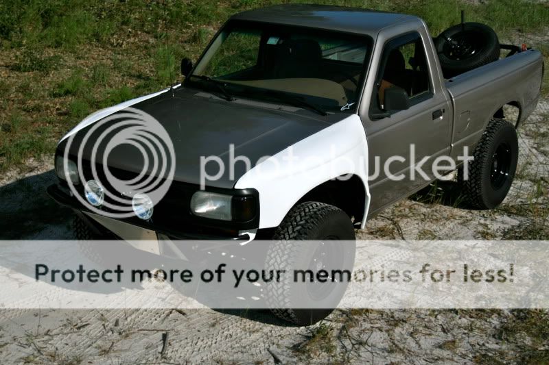

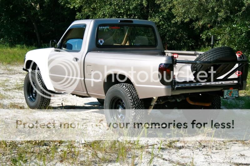

Well i took some pics today of what use to be some good sandy power line trails. Not so much any more....
More soon..... I hope....
~Shawn
where is that....looks like an area down by the glades where we take our rig in the winter
I must say Shawn, you really nailed the stance on that truck.
WOW! just WOW! thats an awesome truck man!! looks soo cool. excellent work!
its good to see a 2WD gettin worked out. so how u really like those31"s with the 4 banger? LOL i want to get the same size for my truck, and ill get 4.10 gears ofr it later on.
keep the amazing work man.
deff subscribed
MountainMike, Thanks, Should have a nicer stance soon with about 2" more higher and wider on each side.
RangerSportHonduras, Thanks man. The 31"s seem fine. To be honest not much really changed as far as power goes. My gearing went out the door. 4.10s with an LSD is in the VERY near future. Once i get the 4.10s ill be going to 33"s General Grabbers.
