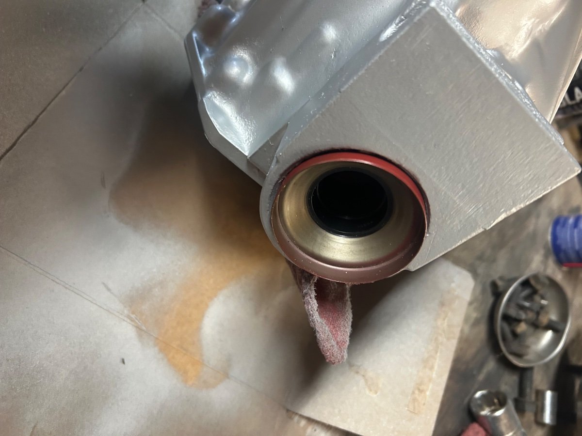

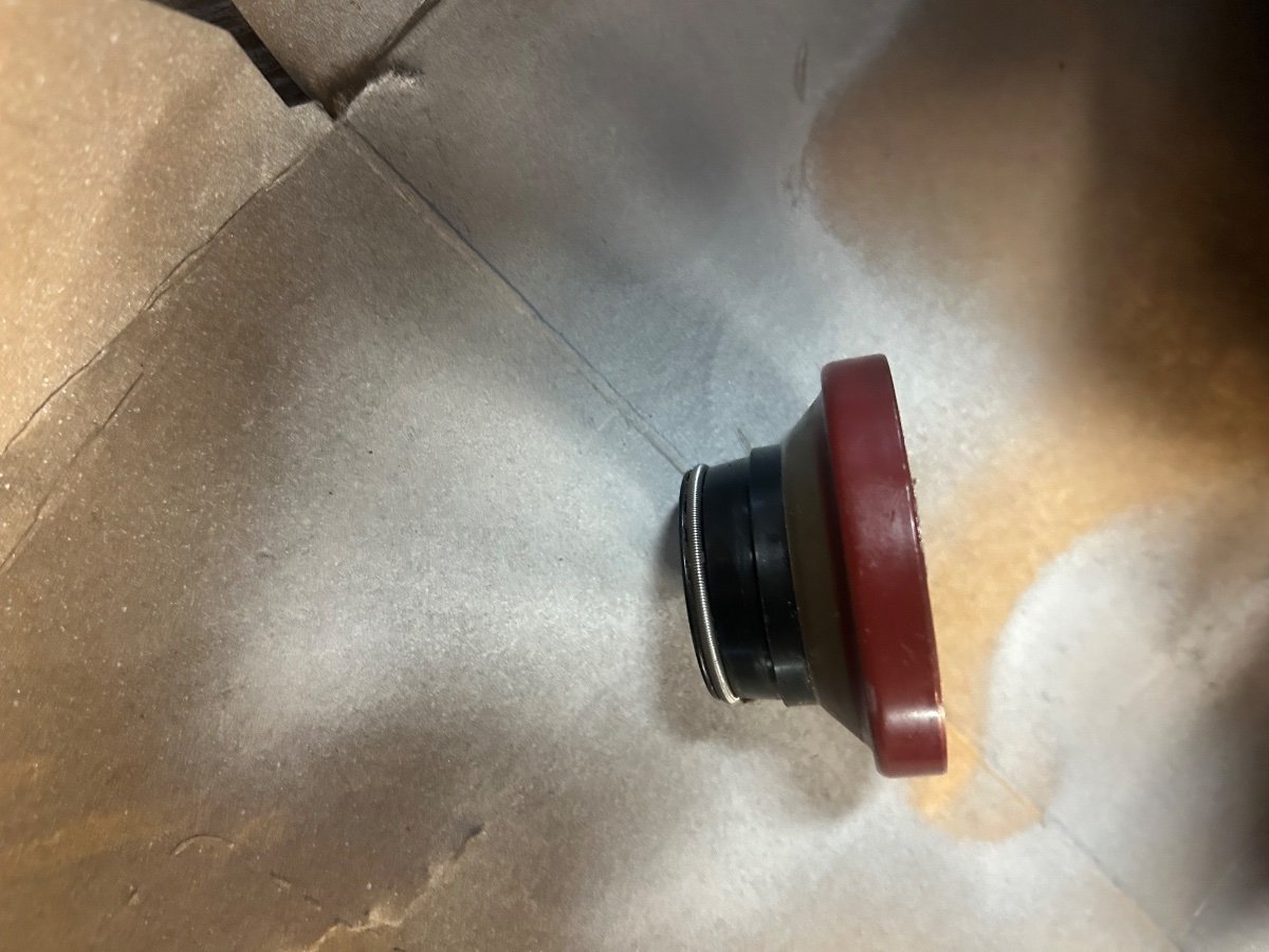

I’ve got a d28 front axle I’ve got the seal for the right side which is only one seal and the left I think has two seals an inner and an outer I’ve got the inner one I just don’t know if there actually is an outer seal

Each side of the differential takes one seal - 32 and 68.
Then, out at the rear of the knuckle is #37.
In that diagram, the outer end of the axle assembly (steering knuckle, brakes, rotor, wheel bearings and seals) is only shown for the driver side. Mirror it for the passenger side.
